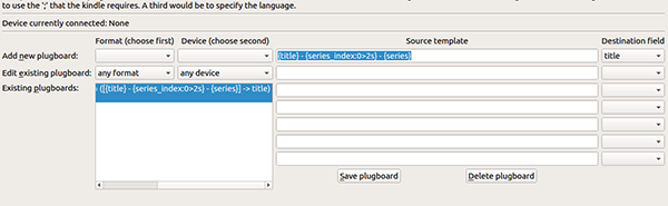

I put the question to this in Calibre Companion by mistake. I need to know how to make sure that the series # transfers to my device when I move books. It was my understanding that once I set it up this way, that is what would happen. It is not. I get the author and book but no #. I have entered the following in metadata plug boards: {series}{series_index:0>2s| #| - }

I'm not that good either, but my Metadata plugboards is working.
{title} - {series_index:0>2s} - {series}

The screen shot is a bit small. Can a larger one be posted?

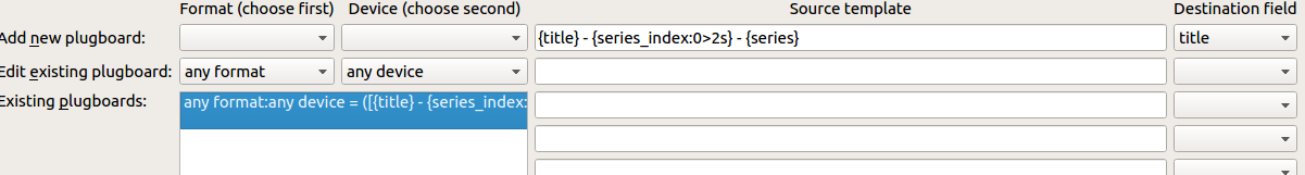

I thought, because of the forum rules, i should resize it. Here a bigger one. =)

Your welcome and thanks for the larger size. Since you are attaching, you can attach larger size images than 600x600.

Thank you, thank you, thank you!!!!! I have been struggling with this for over a week and was ever so close but couldn’t seem to get it right. Thank you so much. You have just made my book collection so much better!
