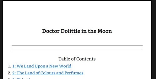

If you are converting from epub to AZW3, yes you should be able to format your <hr> to be thicker (I have used as much as 8 pt.)
But if you are converting to OLD Mobi, I think that will not honor any such styling. Anyway, when I ran a test conversion, my fat 6-pt <hr> turned out very anorexic, looking only like 1 pixel.
You might try putting a second <hr> underneath the first so you have a very widely-spaced double line. Otherwise, for old Mobi, as Tomsem suggests, an image might be your best option.

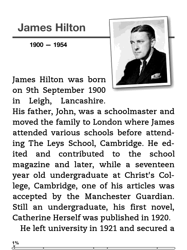

If you are going to work with .kf8 (not the old .mobi format) then don't use <hr> tags but "borders" since you can do whatever by styling borders. For example, watch the borders I employed in the following screenshots of a .kf8 ebook:

You can do something like that by reducing the height of <hx>, <div> or <p> tag to 2 or 3px and then to style the upper and bottom border as you wish. Of course, all that only works with .kf8 (not old .mobi).
Regards
Rubén
