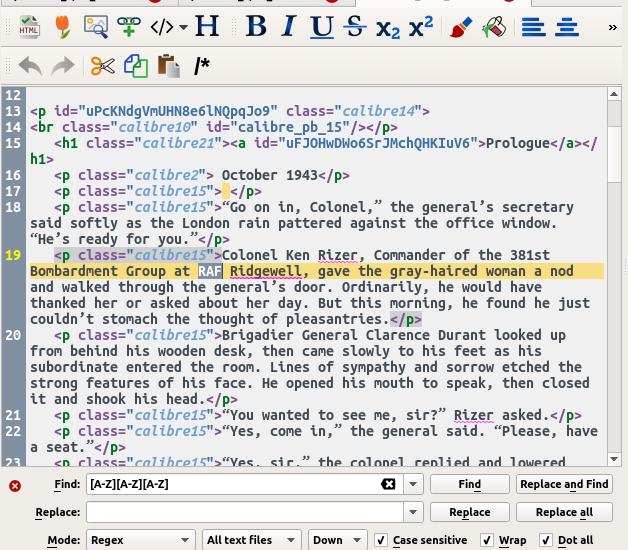

If you are using the calibre ebook editor then all you needed to do was check the box for case sensitive.
bernie
Name:	Screenshot from 2017-11-25 09-49-27.png
ID:	160220   Click image for larger version
Name:	Screenshot from 2017-11-25 09-59-03.png
Er... I'm downright dumbfounded that that check box should affect a REGEX search. It's utility for 'Normal' searches is obvious, but it never even crossed my mind that it would affect a REGEX... that's just... silly!
