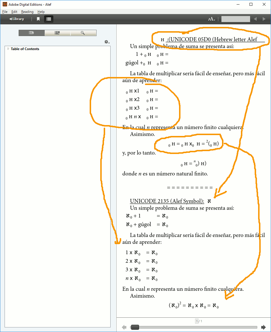

If you tested your EPUB in Adobe Digital Editions (ADE), you would also see that the hebrew alef completely confused it:
