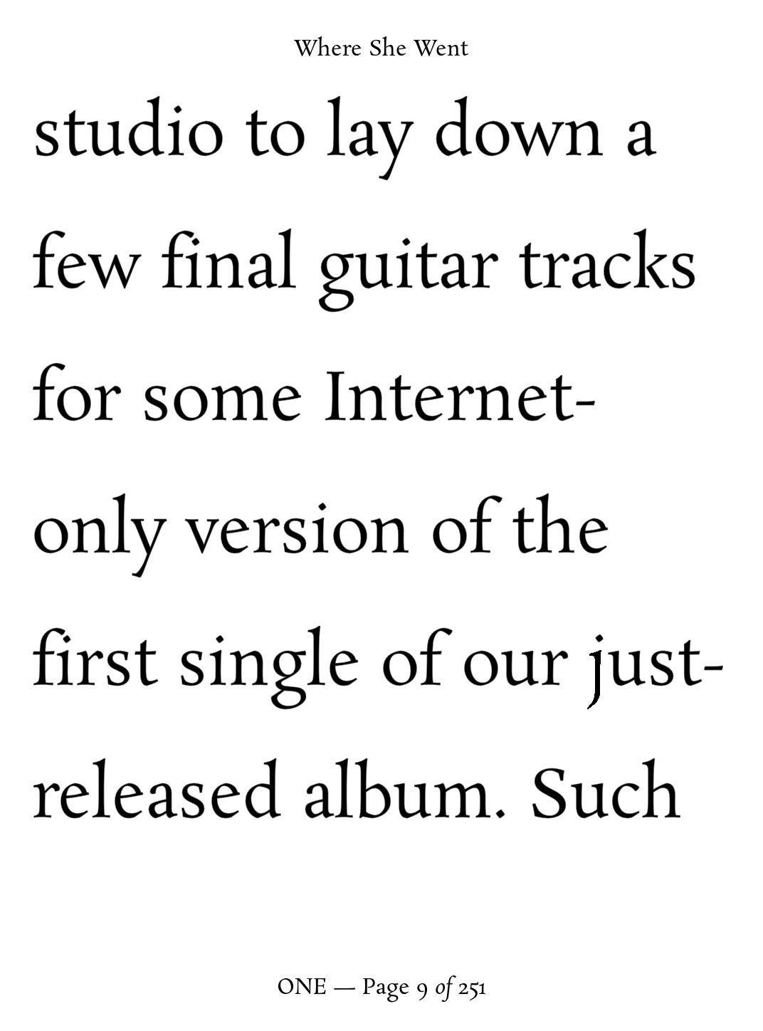

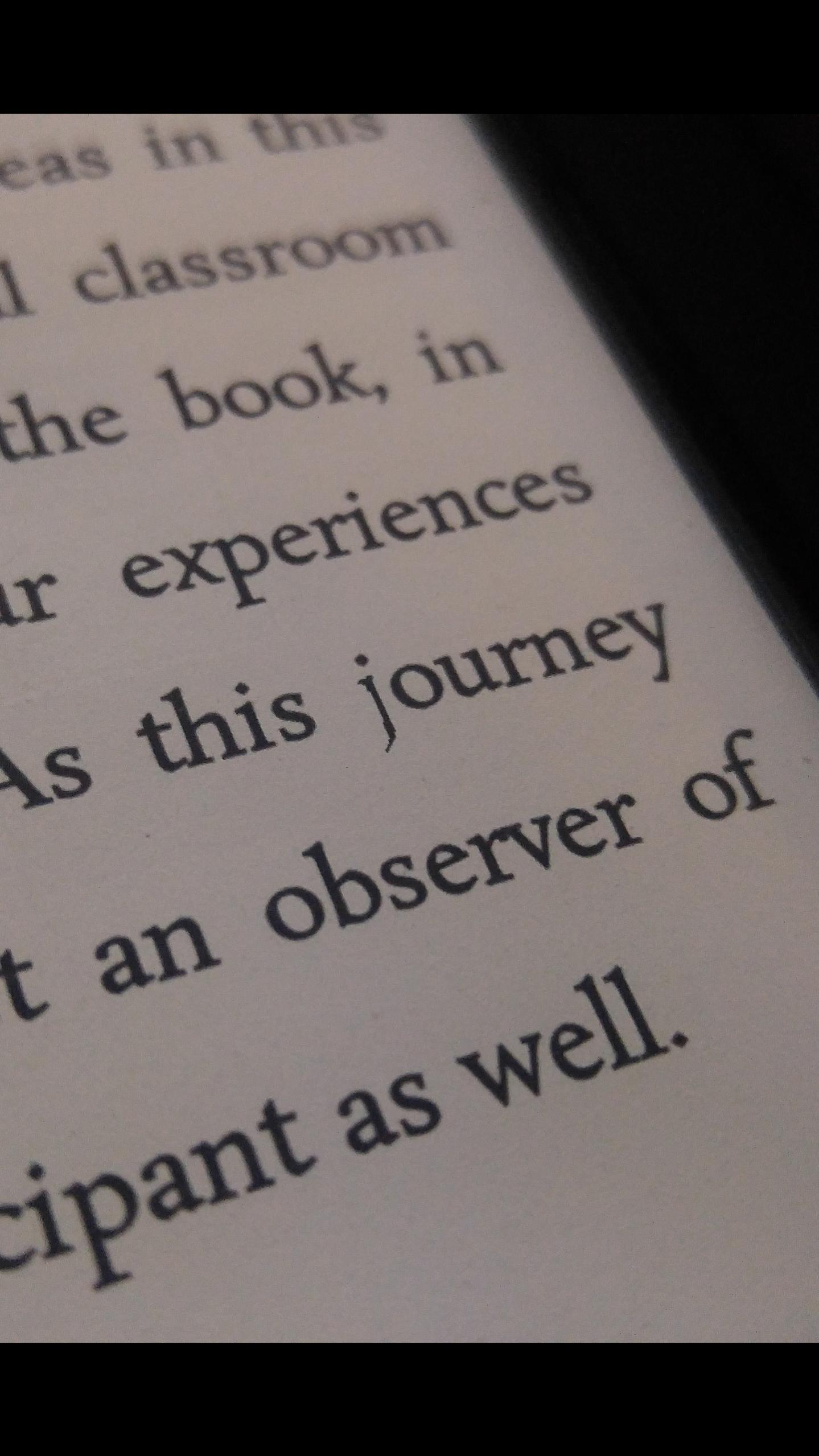

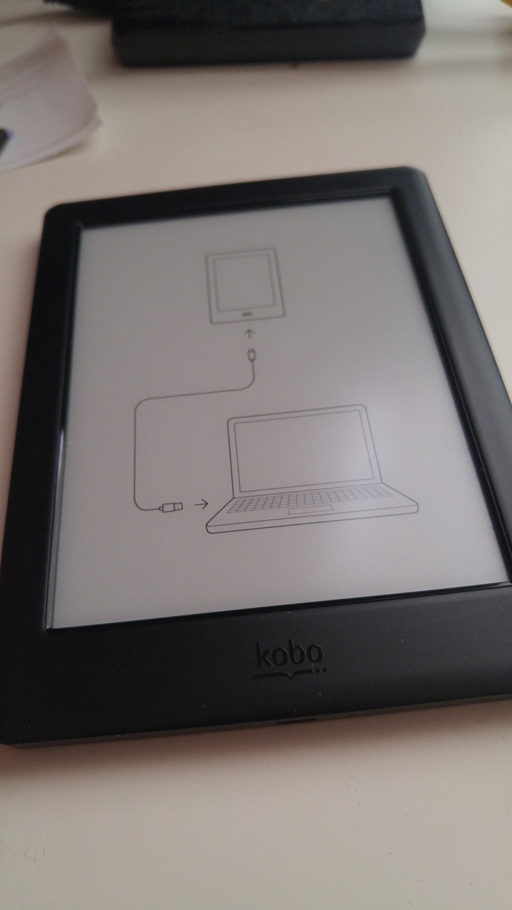

Glo HD has rendering issue for some character.
Rosarivo font is not display properly.
I got new font from Google fonts called Rasarivo.
I love this font, but "j" is not display as I expected on my device (Glo HD).
Only small "j" is not clear like other characters.
I tried to change readingFontSharpness and readingFontWeight.
But there is no big difference.
I attached my screenshot.
If there is someone who know about it, please let me know.

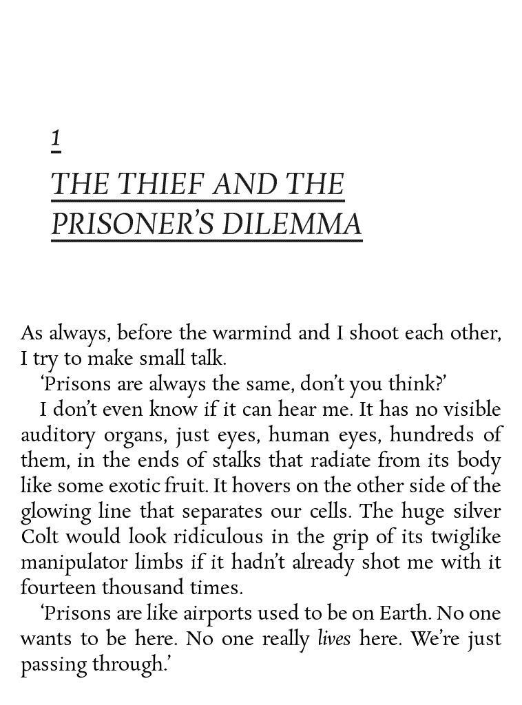

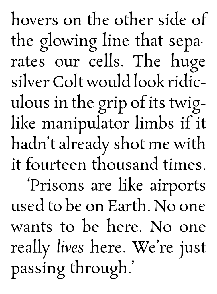

It doesn't look quite right to me either. In your photos the curve at the foot of the j looks jagged, but on my Glo it looks smooth. I don't know what could cause the difference, unless you are using a really tiny font size it should look a lot better on your 300dpi Glo HD than on my 212dpi Glo.
Edit: In the second set of photos you added it might be okay, it is just hard to tell how large the font size is without seeing the whole screen in the photo. If that is a very small font size with a high sharpness setting then it is probably okay. It is really the second photo of the first set that looks strange.

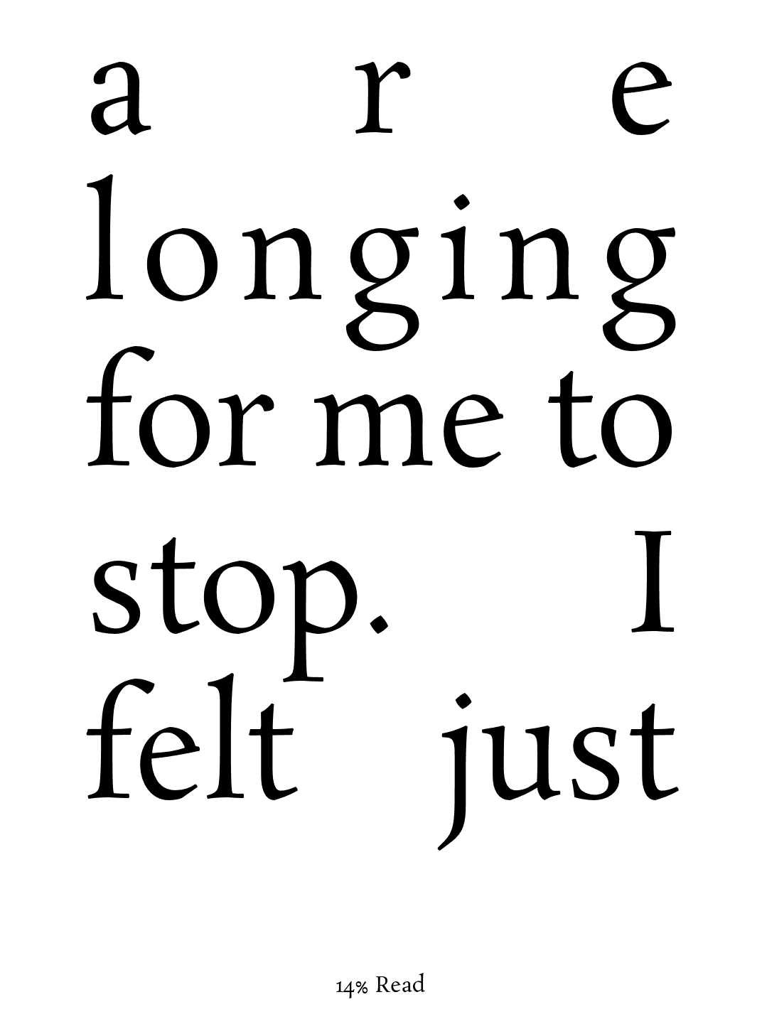

I've attached screenshots from my Glo for comparison, this is in the ePub reader with weight/sharpness at the default settings. (see word 'just' at bottom right.)

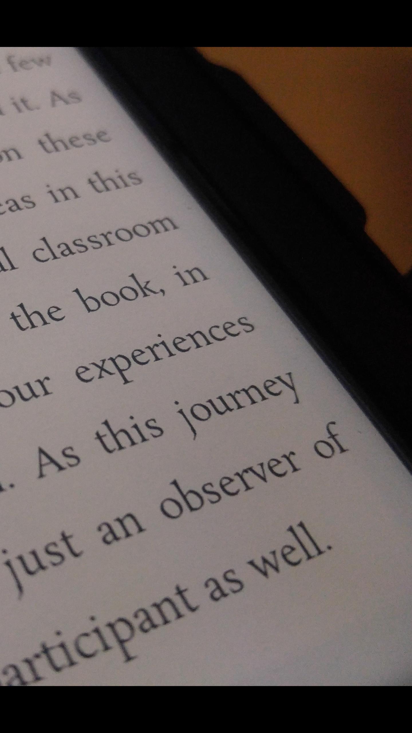

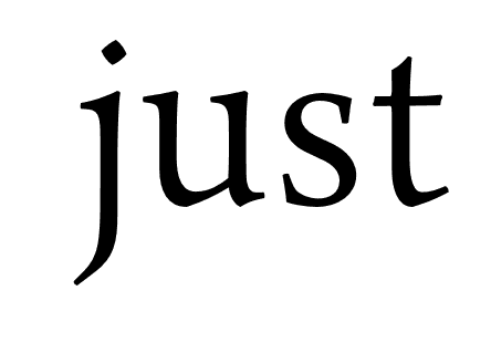

It doesn't matter for size of font.
I tried big font, just "j" was not applied anti-aliasing.

Yes that is very strange, it is clear in your screenshot that the body of the 'j' has no anti-aliasing but the dot does. In the screenshot from my Glo the 'j' is anti-aliased the same as the other letters.
I see you are using the KePub reader, while my screenshot was from the ePub reader. Another difference could be the weight/sharpness setting, mine is at the default setting.
But for only the 'j' to be affected it seems like there must be domething different about that glyph in the font itself. Maybe it is something that can be fixed in fontforge.
You are right.
I tried ePub instead of KePub. It is okay.
Then is there something I can do?
(I want to use KePub)
