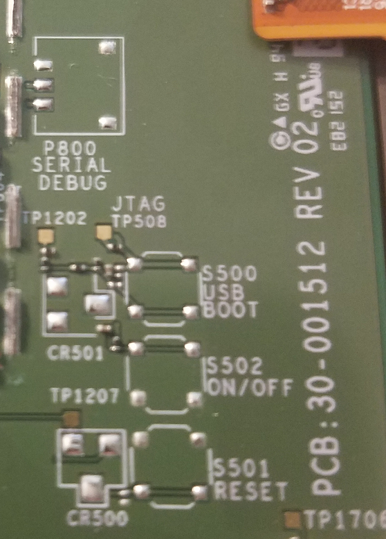

What can I do with my semi-functional PW3 motherboard to help people out?
So I have this motherboard that is water damaged, and I will be replaceing.
Now that I have it out of the case, I notice a lot of pads that aren't populated and I haven't seen mentioned in the threads I have read.
For example, they have the following three switches unpopulated:
"USB Boot"
"Reset"
"On/Off"
I have manually bridged the "On/Off" switch, and it does work like hitting the main power button.
I have not touched the reset button, and I've never worked with USB boot, but I know the other kindles use that to flash, using a process like press home and power at the same time.
Can I use this to do any research that will help anyone out?

It would be great if we can use these switches to put a PW3 into USB downloader mode,
perhaps we can use Kubrick on them?

All of the touchscreen devices share those pads, only the physical location on the board varies.
Post #3 is probable the information someone needs.
https://www.mobileread.com/forums/sh...d.php?t=249979

You have to change the USB boot jumpers back to "normal" before you re-boot.
The i.MX6 requires a special layout boot file to boot from USB.
See the reference manual attached somewhere along that thread.
Buildroot(.org) build system will build the i.MX6 USB boot format file for you.

On an i.MX6 device -
USB boot != USB downloader mode
Both phrases are exact descriptions.

But I'm here to offer, if anyone has anything specific they want me to try, because they don't have a PW3, let me know.
Main warning though, the touchscreen doesn't work so I can't do anything that relies on that.

Knc1, you think it's possible to boot from a bootable USB stick, with some Linux distribution on it?

That is pretty ambitious, I have no way to even guess.
That sounds more like a NFS boot case (the Kindle's do (should) network boot), the newer (than PW1) devices either over USB or WiFi.
At least from the initramfs (the code to setup the root filesystem over NFS is in the code).
Booting from USB stick would be done by the SoC's rom code.
I.E: The first thing loaded and run would be another boot loader (u-boot, red-boot, etc.).
The USB boot file that Buildroot can build, builds u-boot to do the next stage loading.
See: Buildroot.org
(And reading a lot of the ARM reference manual wouldn't hurt your prospects.)
I am pretty sure it is attached to that "KT2 exposed" thread.
