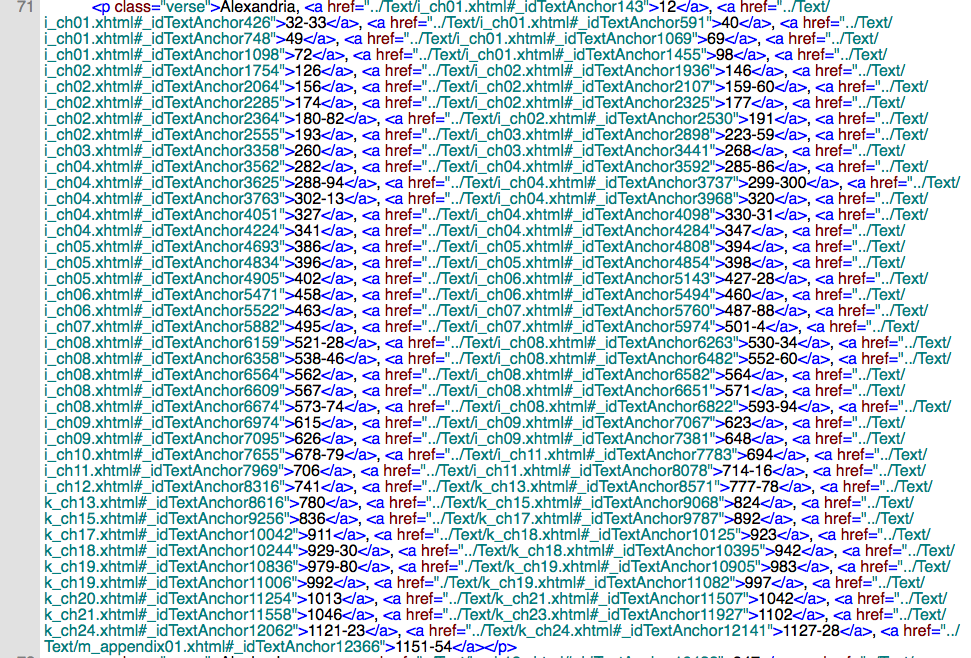

Okay I'm currently working on a 1200+ page ePub, I just ran it through EPUB checker, it came up with 20+ errors. Yesterday I whittled that down to 2. Those 2 errors are in the same line somewhere but, unfortunately the line is VERY long, it's an entry from the index section.
Now my question is, what/where does the col #value stand for? How do I search via that value so I can know exactly where the problem lies in the long string? Is that a character count? I have tried on fixing it manually, but don't see any errors in the code.
(example: line 71, col 4205)

Thank for your help, if you notice there were two hrefs that had improper syntax, somehow (eg <a href="./Text/..., instead of <a href="../Text/) one period and not two. Arrgh!

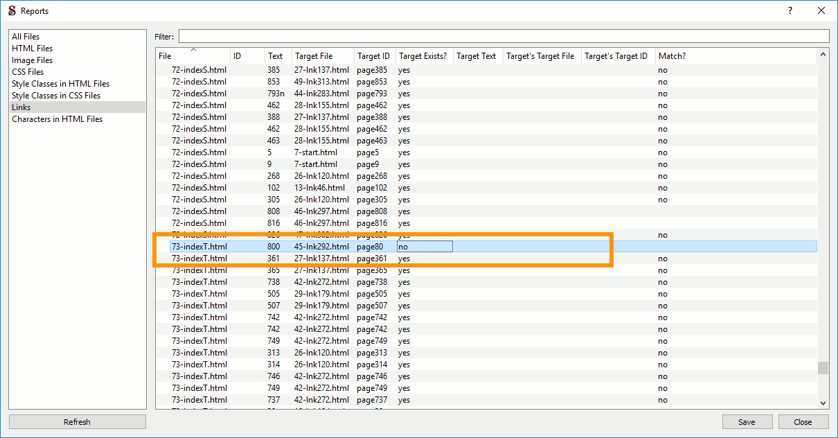

Create a Report using Sigil's tools and look under links It will tell you exactly which anchor's target is missing which is what is generating your error message.
Tools > Reports > Links, then sort by the "Target Exists?" column. If it says "no" then you can go take a closer look.
As an example, "page800" accidentally "page80":
