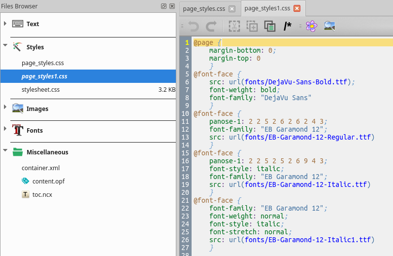

Name:	EB Garamond 12.png
EB Garamond 12
page_styles.css
page_styles1.css
By converting the book calibre automatically install 2 page_styles.css files. Is that normal?
