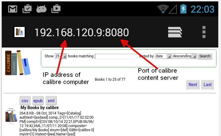

A third thing to check is to verify that I am not smoking something when I say that the device can "see" the calibre computer. Start the content server in calibre, then on the device start a browser and enter
http://ip address:CS port/
You should see something like the following.
Of course the AV/firewall could block this as well. Another connectivity check is to install a network utility that contains a "PING" function and then see if the device can ping the calibre computer. I have used Ping and DNS to do this, but there are a zillion other choices. You can also do the connectivity check from the calibre computer by opening a CMD window and typing

Yes, I tried connecting.
I *was* on-line with Trend Micro when I did the disable.
Safe mode is not easy since I have a lot of stuff active.
Yes, the network is private (and hasn't changed in months)
Yes on the firewall
With the content server test, and 192.168.100.4:9090 using the values I use from the wireless connection, I get
Got the error: Server Error
while trying to obtain http:192.168.100.4:9090
Connection refused.
Using Ping&DNS the ping fails on the IP address.
On another computer on the network, ping succeeds.
Ping from the desktop to the phone fails.
Is this telling us that I am not getting out of the phone ... it browses and all that just fine, but maybe something has changed for other connections?

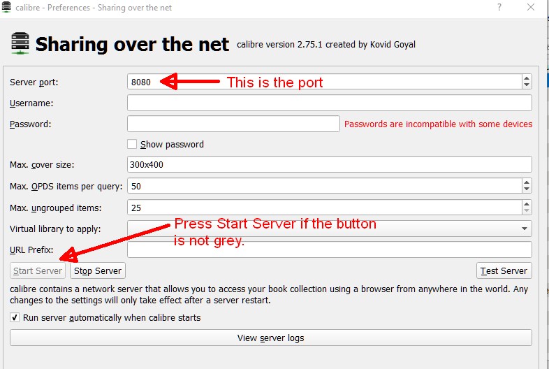

The content server cannot use the same port as the wireless connection. See calibre Preferences / Sharing over the net for the current port and status of the content server.

OK, starting the Content Server and doing the http://192.168.100.4:8080 works.
So, I retried the wireless connection and it didn't work.
So, I tried the browser on 9090 to see if I got the same you did ... and I got a login screen for OpenEdge Management Console (OpenEdge is a software package I develop in, although I don't use the Management Console).
So, I tried starting the wireless connection on 8090 instead and with CC changed correspondingly, it now connects.
While a conflict over port use makes perfect sense and I know that OpenEdge does some default stuff during install that I pay no attention to, since it relates to functionality I never use, it has been nearly a year since the last OpenEdge install so if this was going to be a conflict, it should have been a conflict all along. There have been no changes to OpenEdge in eons and the only changes to Calibre have been the periodic updates.
We have more than one device running CC, but the other is my wife's and she works off her own copy of Calibre on her own machine. It has happened that I have connected to her copy, but 99% of the time there is no possibility since only one of us will have the wireless connection live at a time.
So, looks like the problem is solved ... and the reason clear ... but why it is a new problem is a mystery.

Well, this is a bit embarrassing. The clue was in front of me all along but I simply didn't see it. The calibre log contains the following lines:
Started up in 35.47 seconds with 1173 books
SMART_DEV (   0.04:  0.042) _attach_to_port try ip address "" on port 9090
SMART_DEV (   0.18:  0.000) _attach_to_port socket error on port 9090
SMART_DEV (   0.25:  0.029) _attach_to_port try ip address "" on port 19285
SMART_DEV (   1.11:  0.811) startup_on_demand listening on port 19285
Note the third line, which says that something else is listening on port 9090.
