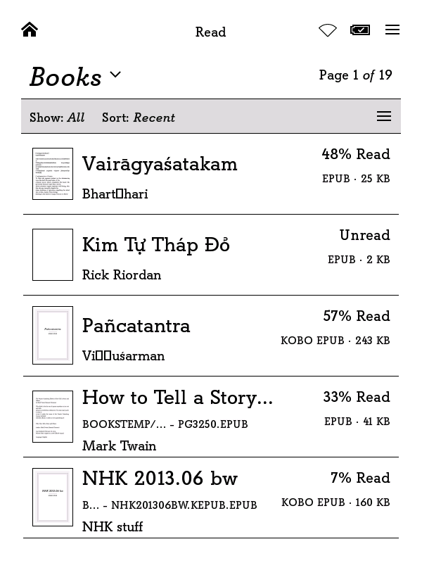

You can make Vietnamese fonts work in the GUI by removing all interfering fonts. I was to lazy to find out which fonts actually do interfere, and simple removed any font but KoboNickel. As you can see on the picture, Vietnamese is shown.
Since somebody asked in another thread for Vietnamese and Sanskrit transliteration: You can also see in the first image that nickel does not support all diacritics needed to display transliterated Sanskrit. But as soon as one opens a kepub/kepub.epub, the GUI starts using the custom fonts too (see the second image).

Hi tshering,
Thank you for your reply!
My first attempt did not work well. Actually, I made my KA1 unbootable and need a factory reset.
In my second attempt, the good news is my KA1 still works , however, the problem of missing some characters is not yet solved.
I tried to remove Avenir, Amasis, Caecilia, Georgia and KBJ-UDKakugoPr6N-M -> doesn't work. Even when I deleted all fonts except KoboNickel or rename the whole folder, it still keeps the default system font.
Hmm, did I miss something?

haidinhtuan,
are you sure that you deleted the fonts that you wanted to delete? Or that you renamed the whole folder? If I delete all fonts in /local/Trolltech/QtEmbedded-4.6.2-arm/lib/fonts/, not a single character is shown in the GUI, but only squares. Maybe you did some typo when writing the path.
How are you rename/delete the folders/files? By script? By telnet? Or did you overwrite the files with empty files?

Originally Posted by tshering View Post
haidinhtuan,
Hi, tshering. Firstly, I use a fresh copy of Kobo firmware and edit the archive directly (delete fonts in usr/local/Trolltech/QtEmbedded-4.6.2-arm/lib/fonts/), then copy the KoboRoot.tgz file into .kobo folder of the reader. I've read somewhere that Kobo device always checks for KoboRoot.tgz file in .kobo folder and if such a file exists, the reader will extract the file and overwrite it on current system files.
Am I doing wrong? From your reply, I feel like I have to delete fonts directly in the reader??
