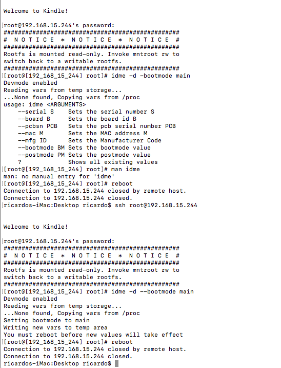

Thanks, sometimes is hard to find the right information, I find some instructions on the README.txt of the Rescue Pack.
However, after doing what it said, the Kindle still goes back to System Diags, I'm not sure if I have to mount some filesystem. Better ask before messing something up.
This is the ssh session, if there is some useful information:

That triggers CRP.
You probably do not need CRP, it is just a feature add-on to RP.
