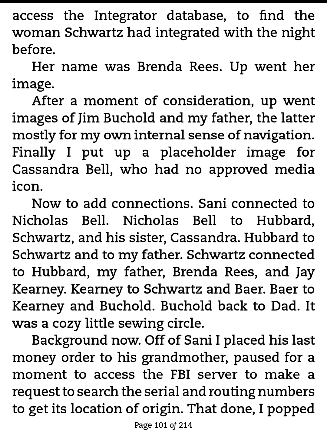

The custom reading footer style, can we still get the text very close to the footer for RMDSK?
Yes, but I haven't yet found out how to add padding between the bezel and footer, or how to change the font size used for the page numbers.
Below is the first replacement string in the Custom reading footer style patch, I've highlighted the footer heights in red: Change the 24px values for Touch/Mini; the 30px values for Glo/Aura; and the 40px values for AuraHD/H2O.
replace_string = 0000, `ReadingFooter {\n\tmin-height: 70px;\n\tmax-height: 70px;\n\tqproperty-footerMargin: 105;\n}\n\nReadingFooter[qApp_deviceIsPhoenix="true"] {\n\tmin-height: 82px;\n\tmax-height: 82px;\n}\n\nReadingFooter[qApp_deviceIsDragon="true"] {\n\tmin-height: 120px;\n\tmax-height: 120px;\n\tqproperty-footerMargin: 170;\n}`, `ReadingFooter {\n\tmin-height: 24px;\n\tmax-height: 24px;\n\tqproperty-footerMargin: 105;\n}\n\nReadingFooter[qApp_deviceIsPhoenix="true"] {\n\tmin-height: 30px;\n\tmax-height: 30px;\n}\n\nReadingFooter[qApp_deviceIsDragon="true"] {\n\tmin-height: 40px;\n\tmax-height: 40px;\n\tqproperty-footerMargin: 170;\n}`
Edit: Below is the second replacement string that affects the reading footer style. Font sizes can be changed (highlighted in red: Touch/Mini = 16px; Glo/Aura = = 20px; AuraHD/H2O = 26px; Alyssum = 30px; ) but problems arise when I try to add padding:
Replace_string = 0000, `#caption {\n\tfont-size: 16px;\n}\n\n#caption[qApp_deviceIsPhoenix="true"] {\n\tfont-size: 20px;\n}\n\n#caption[qApp_deviceIsDragon="true"] {\n\tfont-size: 26px;\n}\n\n#caption[qApp_deviceIsAlyssum="true"] {\n\tfont-size: 30px;\n}\n\n#caption[qApp_localeName="ja_JP"] {\n\tfont-family: A-OTF Gothic MB101 Pr6N;\n}`, `#caption {\n\tfont-size: 16px;\n}\n\n#caption[qApp_deviceIsPhoenix="true"] {\n\tfont-size: 20px;\n}\n\n#caption[qApp_deviceIsDragon="true"] {\n\tfont-size: 26px;\n}\n\n#caption[qApp_deviceIsAlyssum="true"] {\n\tfont-size: 30px;\n}\n\n#caption[qApp_localeName="ja_JP"] {\n\tfont-family: A-OTF Gothic MB101 Pr6N;\n}`

Here is a new `Custom reading footer style` patch. It allows most of the customisations possible with the patches from earlier firmare versions, but it does it a bit differently because it doesn't seem possible to add padding to the footer anymore, so you might need to use a bit of trial and error to get the footer exactly how you had it before.
<Patch>
patch_name = `Custom reading footer style`
patch_enable = `yes`
# Multi-version patch: 3.13.1 - 3.13.1+
# This patch customises the following properties of the reading footer:
#  * Footer height (the amount of the screen reserved for the footer.)
#  * Caption font size (Caption = page number or other progress indicator)
#  * Caption top margin, which changes its vertical position within the footer.
# When editing the replacement values below, BE CAREFUL NOT TO CHANGE THE LENGTH
# OF THE REPLACEMENT STRING! If a replacement string is too long you will get

Here are the settings I used on my H2O for the footer. First try and I'm happy with it.
<Patch>
# an error when making the patch, but if one is too short then there will be no
# error, but strange things will happen to the reading footer.
find_base_address = `ReadingFooter {\n\tmin-height: 70px;`
# Replacement footer height values: Touch/Mini
#replace_string = 0011, `min-height: 70px;`, `min-height: 32px;`
#replace_string = 0024, `max-height: 70px;`, `max-height: 32px;`
# Replacement footer height values: Glo/Aura
#replace_string = 0085, `min-height: 82px;`, `min-height: 40px;`
#replace_string = 0098, `max-height: 82px;`, `max-height: 40px;`
# Replacement footer height values: AuraHD/H2O
replace_string = 00DA, `min-height: 120px;`, `min-height: 038px;`
replace_string = 00EE, `max-height: 120px;`, `max-height: 038px;`
find_base_address = `#caption {\n\tfont-size: 16px;`
Replace_string = 0000, `#caption {\n\tfont-size: 16px;\n}\n\n#caption[qApp_deviceIsPhoenix="true"] {\n\tfont-size: 20px;\n}\n\n#caption[qApp_deviceIsDragon="true"] {\n\tfont-size: 26px;\n}\n\n#caption[qApp_deviceIsAlyssum="true"] {\n\tfont-size: 30px;\n}\n\n#caption[qApp_localeName="ja_JP"] {\n\tfont-family: A-OTF Gothic MB101 Pr6N;\n}`, `#caption {font-size: 16px;margin-top: 00px;}\n#caption[qApp_deviceIsPhoenix="true"] {font-size: 20px;}\n#caption[qApp_deviceIsDragon="true"] {font-size: 26px;}\n#caption[qApp_deviceIsAlyssum="true"] {font-size: 30px;}\n#caption[qApp_localeName="ja_JP"] {font-family: A-OTF Gothic MB101 Pr6N;}`
# Replacement caption font size value for Touch/Mini:
#replace_string = 000A, `font-size: 16px;`, `font-size: 16px;`
# Replacement caption font size value for Glo/Aura:
#replace_string = 0054, `font-size: 20px;`, `font-size: 20px;`
# Replacement caption font size value for AuraHD/H2O:
#replace_string = 008C, `font-size: 26px;`, `font-size: 26px;`
# Replacement caption font size value for Alyssum:
#replace_string = 00C5, `font-size: 30px;`, `font-size: 30px;`
# Replacement caption top margin value for all devices:
# (A negative top margin moves the caption text upwards,
# further from the bezel and closer to the page content.)
replace_string = 001A, `margin-top: 00px;`, `margin-top:-10px;`
</Patch>
