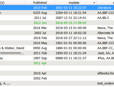

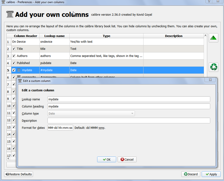

As theducks said, the Date column is really a full timestamp. If you set the format for the column to something like
yyyy-MM-dd hh:mm:ss
then you will see and be able to enter/modify the time.
Given your use case, you might also want to use the keyboard shortcut to set a date column to the current day/time. Edit the column (usually by positioning the cursor in the field and pressing F2 to edit) then press CTRL= (control + equals) to set the date to "now".

Originally Posted by mariaclaudia View Post
Thanks for answerig. I did this, but nothing happend. What I do wrong?
I don't know.
First possibility: did you restart calibre?
Second possibility: are there really values in the column for those books?
EDIT: Try running calibre in debug mode and see if it displays anything.
Here are the equivalent images for me.

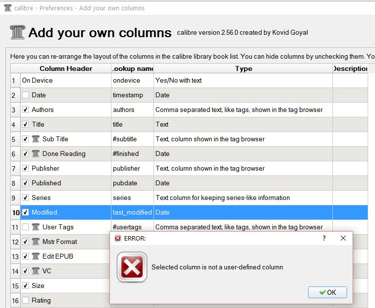

Your example is a STANDARD (column) field. (note the type timestamp)
date is really a timestamp, but it may have more flexibility
FWIW my last_modified (lookup name) is Date Type and will not let me format it in Add your own Collumns Tweaks: gui_pubdate_display_format

The picture in post #5 should not be possible
last_modified is a system NAME.
When I try and format it like a USER (custom) column...
I use the Tweaks to set the format
There is no problem with using last_modified as a lookup name. Calibre turns it into #last_modified, a different column that has no relationship to the system column. You could do the same thing with "tags", getting #tags.
On the other hand, things might get confusing if the column headings are the same as a system column.
