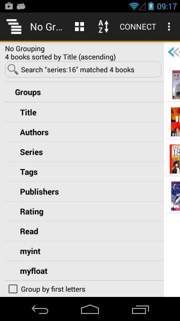

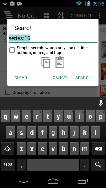

Edit: here are some screen captures

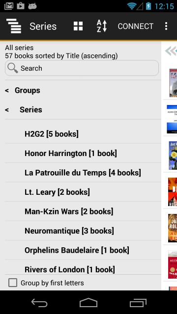

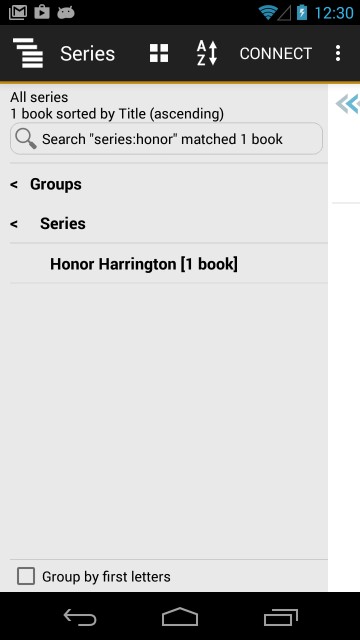

It works fine for me. Here are two screen captures that show it.

Ahh ... there might be an issue with letter case with the "contains" search, which is the default. I will check that.
