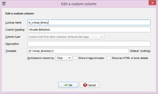

Sometimes it is good to know to what virtual lib a book is linked (if a book is part of more than one virtual library). In this case this is maybe useful for you too:
Create a custom column build from other column and use the template function
{0:'virtual_libraries()'}
