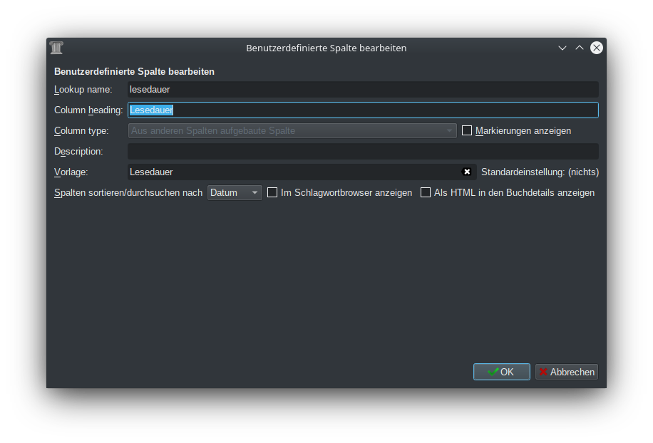

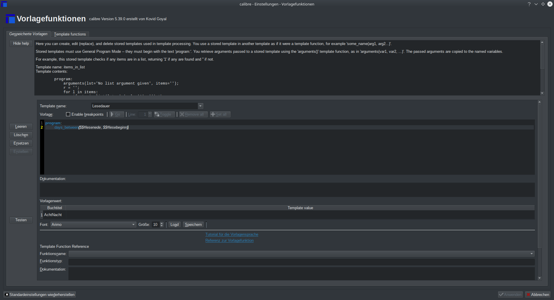

I think I don't understand something.
I have copied in the templates and changed for me and have specified the template in the column. Shouldn't it actually work then?
Please excuse my stupidity

program: Lesedaeur()
Old 03-18-2022, 06:30 PM   #6
quarkpott
quarkpott began at the beginning.
Posts: 22
Join Date: Jul 2017
Then 0 is displayed in the column, although it should actually be 2
quarkpott is offline   Reply With Quote

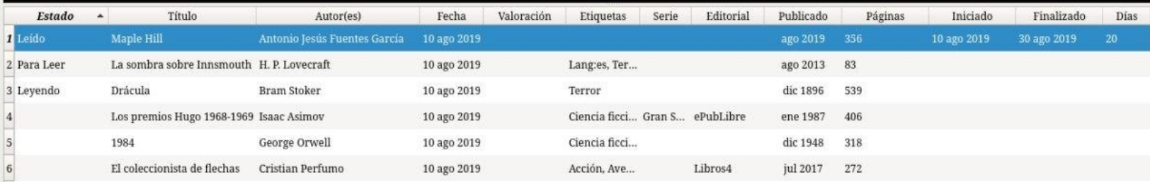

Old 03-20-2022, 05:10 PM   #15
dunhill
dunhill's Avatar
Posts: 930
Karma: 810834
Join Date: Sep 2017
They appear to me like this, like the image
The columns I have are:
Status (Read, To Read, Reading)
Title
Author
Date (From Calibre)
Ranking
Serie
Editorial
Published
Pages
Started (Read start date)
Finished (Date the reading finished)
Days (Number of days to read it)
