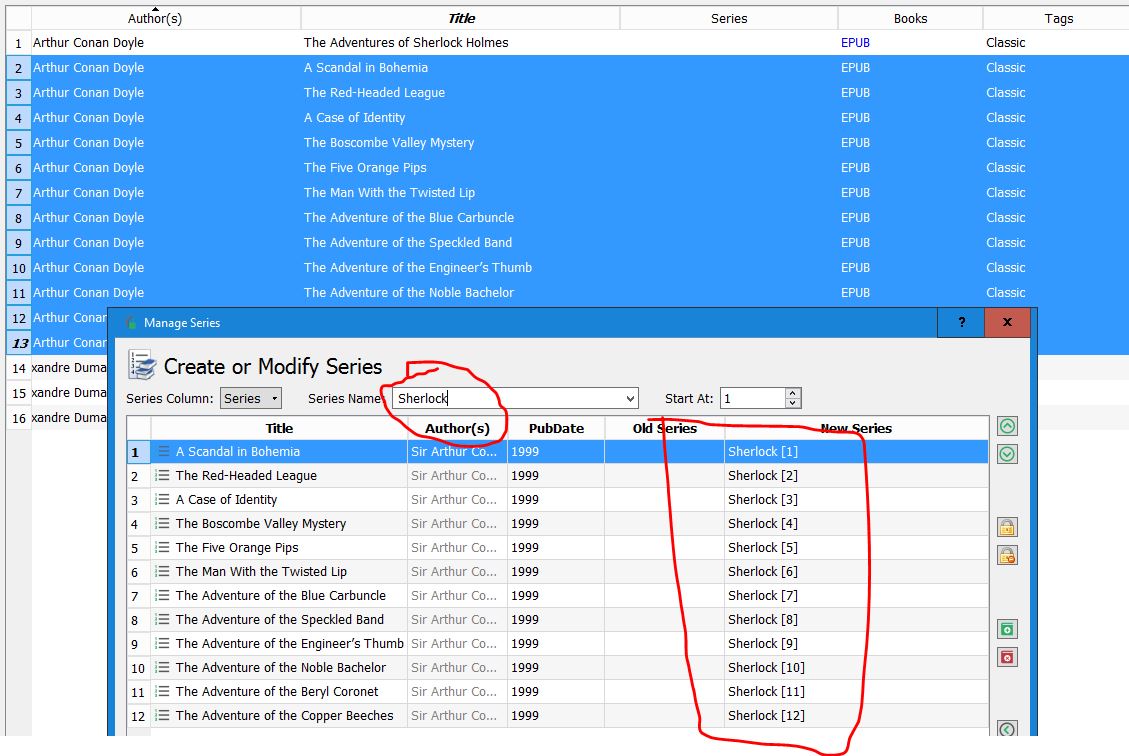

Look at the Manage Series plug in. It has a lot of nice options

Isn't there an option for this already on the Basic Metadata Tab when selecting multiple books?
Automatically Number / Start from etc.?
Yes and No.
That only controls during the ADD (tha is done by a Tweak setting)
Bulk MDE is more limited (simple) than the PI
The Manage Series PI allows total manipulation of the series[n] field
(name and index) for the selected group of books
