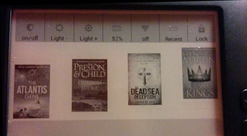

Currently I'm using the "CC Book Grid 3x1" with 4 covers. I have a Energy Sistem Pro+ Reader with Nova Launcher. Works very well
I have resized the widget and set padding to off in Nova Laucher, so that the widget covers the entire width of the screen. However, the covers do not scale very well, as you can see on the image. They should fill the maximum space available for the widget, don't you think?
And I guess the covers should be centered in their "box" and not "stacked" as on the image.
I use a blank wallpaper, but optionally adding a border and an opaque background would be great, too. For those who like it it could be one of the "bookshelf" textures, but I would prefer a single color.
Having a second widget with recently added books would be great, too.
Same general layout than the other widgets, but instead of read books add the covers of recently added books in descending order. To distinguish the widgets you could add a small title in the upper left or right corner.
Like on most stock eBook launchers one could then create two rows of covers with currently read and newly added books.

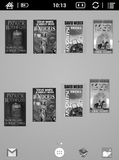

That must be a stack widget, not a grid widget. Below is a screen capture off my Afterglow 2 (my wife has my Energy Systems Pro). The top widget is a 4-wide grid widget. The bottom one is a 4-wide stack widget. The bottom one looks like yours.
I'm feeling a little bit embarrassed right now. Of course you're right, it was a stack widget on my eBook reader
I just checked the cover shape "Square box, stretch to fit". The covers now completely fill the width of the screen, but they sure are ugly
The setting "Portrait box with aspect ratio" looks way better. However, the widget still puts some millimeters of unused space around all covers. It would be great if you could draw the covers right to the edge of the widget like in square box mode, filling as much as possible of the widget.

I used Android Studio, the development environment I use for CC programming. The screenshot was in color, so for consistency I used irfanview to convert it to grey scale.
