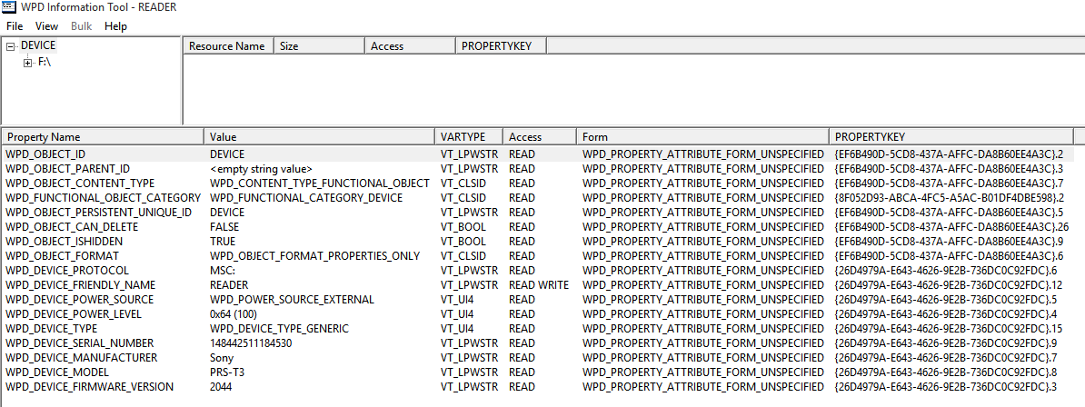

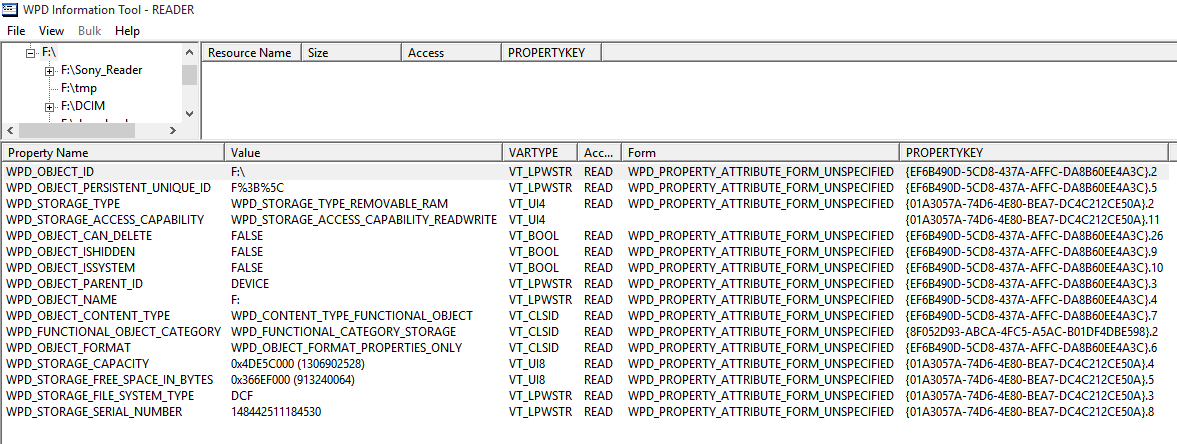

After reverting to Win7 I did another update to win10 today.
Again the reader is not detected by calibre.
I did some reading and came across a WPDInfo tool which can list windows portable devices.
The reader is listed in wpdinfo and one can access its properties. I have added some screenshots. Is this helpful to analyze the problem?
Best regards,
profigriller
