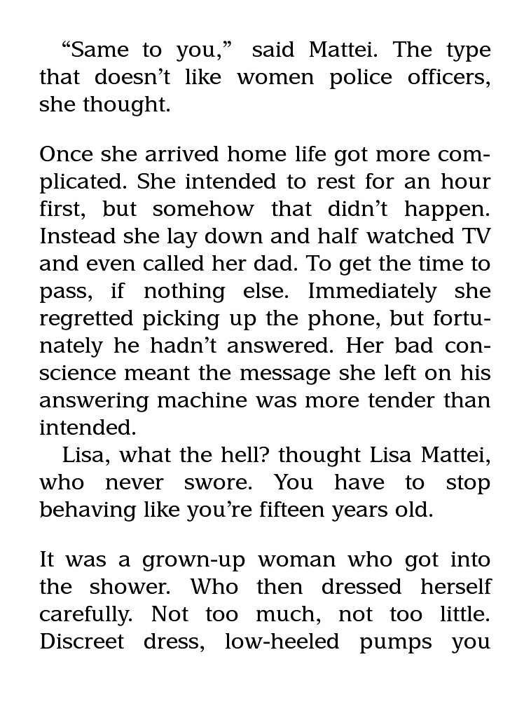

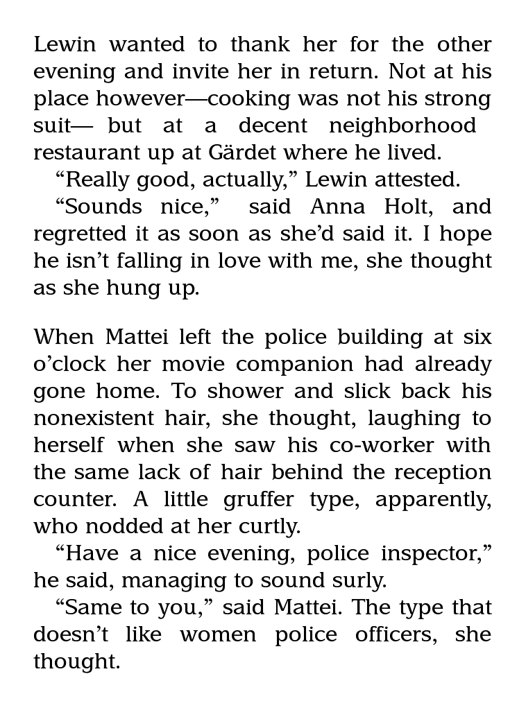

I'm not arguing with it but am interested in why you've reached this conclusion as it's never caused me any problems ... so far.
The problem is what happens when the scene break occurs at the bottom of a page.
If the last line of the previous scene falls at the very bottom of the page then any margin-top on the first line of the next scene will be absorbed into the page margin-top of the next page (depending on how wide the page margin is), and so it can be impossible to see that there was a scene break at all.
Edit: Attached are screenshots from my Glo (3.16.0) reading this book synced from Kobo in full-screen mode (but the effect is the same in normal mode, and it is not Kobo-specific as it happens in Calibre's ebook viewer too.) This book has a lot of scene breaks.
These two shots show a scene break made with a 1em margin split across two pages. The new scene begins Once she arrived home ... at the top of the second page:

In this case it is easy to see that there is a scene break because the last paragraph of the scene ends with a very short line, but it is not always so obvious. It would be worse for those who read ragged-right, or if the opening pararaph is not flush-left.
