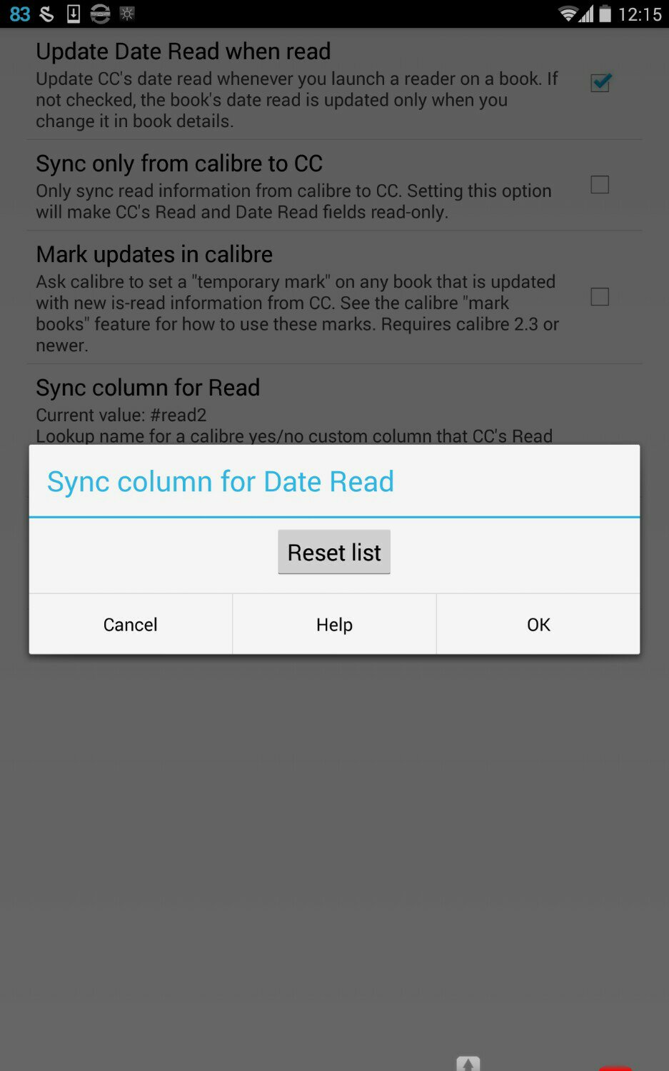

Is it correct behavior to not allow me to add the read date column name by typing it in? I don't see a way to do that, so I'm syncing first. With almost 1,000 books it takes a few minutes to sync so I'd rather just type the name in. Or did I miss something?
A long time back you could type in the names. That went away when the pick-and-choose interface was added. Thus yes, you must sync once before you can set the read date. If this is a new CC install then you can turn off auto-scan to make this first sync go a lot faster.
This wasn't a new install and I have auto-scan off. I added two new columns to Calibre so it ended up doing two syncs and two db upgrades(I think). The first sync and db upgrade was for the new column that wasn't the read date. After that I could choose the date read column which I think triggered a new sync and it did a db upgrade.
