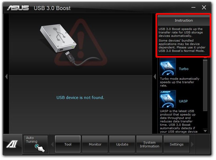

@Richard59 - did you try tweaking the ASUS USB driver to Normal ?
Would have thought that should only effect USB3 ports, but maybe worth a try.

BetterRed.... You-da-man.
Somehow USB3 boost had been turned on for that device. I don't remember doing this but switching it to normal did the trick. Now when the KOBO is connected there is only one instance of it appearing in Devices & Printers and Calibre connected to it in about 3 seconds. Big Thanks all for your help in resolving this issue.

@Richard59 - its probably on by default - it purports to make things faster, so if you're ASUS it would make sense to have it on.
My understanding is that not all "Boost" facilities on USB 3.0 adapters are the same, in fact I suspect their all bloody different. Whaddya get if yer put one walled garden in anuva walled garden - a $#@*& maze
