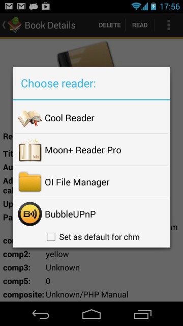

Regarding your problem, CHM works fine for me with CC3.3.5. See the following screenshots:
1) The book details of the PHP manual in CHM, as demonstrated by the path.
2) The result of tapping the Read button.
3) The manual displaying in Moon+
Clearly you are doing something different from me.

It would be helpful if you send me a CC debug log from the app (Settings, email a debug log to MultiPie). Please post here if you do that, because given that we haven't received any previous emails from you, we might not get this one either.
