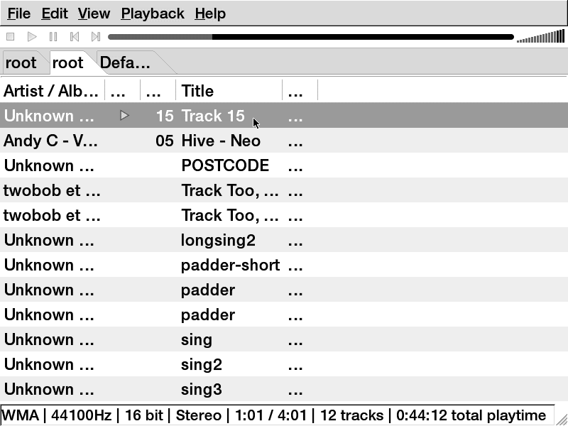

deadbeef present several of the age old problems when building for the touch.
a) how do I build it (see below)
b) will the windows be randomly huge or lay over each other (see below)
c) will it support alsa (see below)
d) can it live on FAT (see below)
e) will its configs be wiped everytime I turn it off (see below)
f) will keyboard input work (see below)
g) does it have a single window interface (no floating toolbars)
until at least 6, and ideally 7, of those answers are "Yes or Easily" an app can't be properly released. People will complain.
However. as an interim solution i am sharing my build files and some rough notes.

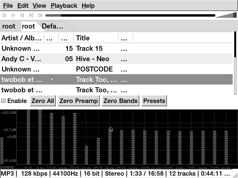

Plugin Summary:
stdio: yes - Standard IO plugin
gme: yes - chiptune music player based on GME
nullout: yes - NULL output
alsa: yes - ALSA output
oss: yes - oss output plugin
pulse: no - PulseAudio output plugin
coreaudio: no - CoreAudio output plugin
sid: yes - SID player based on libsidplay2
ffap: yes - Monkey's audio (APE) decoder
lastfm: no - last.fm scrobbler
mpgmad: yes - mpeg player based on libmad
vorbis: yes - ogg vorbis player
flac: yes - flac player
wavpack: yes - wavpack player
sndfile: yes - PCM (wav,aiff,etc) player based on libsndfile
vtx: yes - vtx file player (ay8910/12 emulation)
adplug: yes - adplug player (OPL2/OPL3 emulation)
vfs_curl: no - http/ftp streaming support
cdda: no - cd audio player
gtkui: yes - GTK2 user interface
gtkui3: no - GTK3 user interface
hotkeys: yes - Local and global hotkeys support
ffmpeg: yes - ffmpeg codecs
artwork: no - Cover art plugin
supereq: yes - Equalizer based on Super EQ library by Naoki Shibata
notify: no - notification-daemon support plugin
shellexec: yes - shell commands plugin
shellexecui: yes - GTK user interface for setting up shellexec plugin
musepack: yes - musepack player plugin
wildmidi: yes - WildMidi player plugin
tta: yes - TTA player plugin
dca: yes - libdca (DTS Audio) player plugin
aac: no - AAC player (m4a, aac, mp4) based on FAAD2
mms: yes - mms streaming support
dsp_src: yes - High quality samplerate conversion using libsamplerate
m3u: yes - M3U and PLS playlist support
vfs_zip: no - zip archive support
converter: yes - plugin for converting files to any formats
psf: yes - PSF format plugin, using AOSDK
dumb: yes - DUMB module plugin, for MOD, S3M, etc
shn: yes - SHN plugin based on xmms-shn
mono2stereo: yes - mono2stereo DSP plugin
alac: yes - ALAC plugin
wma: yes - WMA plugin
pltbrowser: yes - playlist browser gui plugin
GETTING THE SUPPORTING LIBS
we can apt-get bits we need like:
apt-get install intltool libtool automake
sadly there is no apt-get build-dep deadbeef
so in pinch do: apt-get build-dep audacity && apt-get build-dep aqualung
they should cover the same bases.
run ./configure --help or ./configure and see what you are missing of that which you wanted. The above technique worked for my needs. Ogg, Mp3, wav, wmv etc.. etc.. )
I went with --disable-gtk3 --disable-nls --enable-abstract-socket to get around a bind issue and cut down on extras.
do a make && make install
your program appears in </mnt/debian>/mnt/us/extensions/<thing>/
where /mnt/debian is the location of your armel debian root via qemu on your host PC.
the script I referenced earlier Exporting Binaries Easily from Debian will then rip out all the required libs and shove them in one folder. (settable in the script, I choose /export) and then it is up to you to dump the exported "lib" folder contents into the folder you referred to in the "LDFLAGS="-Wl,-O1 -Wl,-rpath,/mnt/us/extensions/deadbeef/lib" (after ripping out the pthreads, gcc, librt, libm, libresolv, etc...)
so - that is to say - create a "lib" dir if you don't have one created by the make of your app in your armel output folder /mnt/us/extensions/<thing>/ like /mnt/us/extensions/<thing>/lib
(which is </mnt/debian/>/mnt/us/extensions/<thing>/ from the parent OS remember)
and shove the exported libs (from the Exporting Binaries Easily from Debian tool) into it.
Then copy all of the folder and its contents from </mnt/debian/>/mnt/us/extensions/<thing>/ into /mnt/us/extensions/<thing>/ on your kindle. via USB or ssh.
I personally will zip it before I transfer it and unzip it into the kindle /mnt/us/extensions/ dir. This unrolls symbolic links in a sane way to hard files and stops the permission denied errors that trying to create a sym link on FAT will give you.
you are ready to test it via ssh.

And we are running (pictured)
