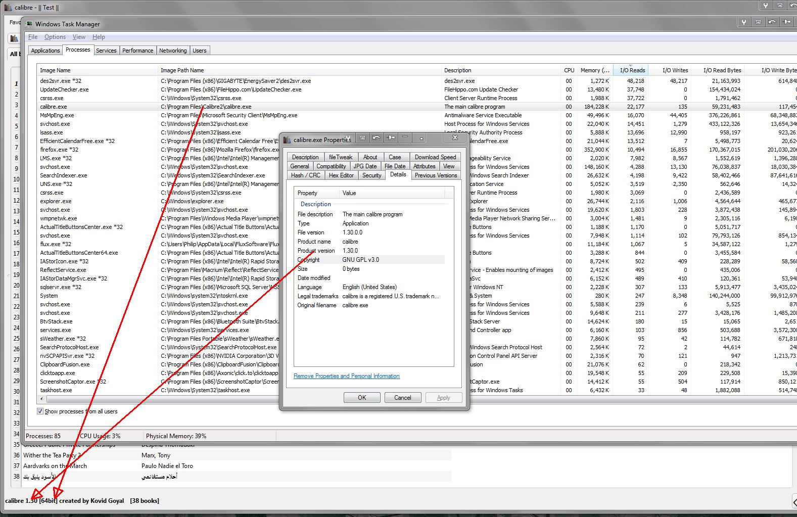

Posts: 22,036
Karma: 30277960
@Buecherfan - just to be sure look at Task Explorer->Processes-->Image Path Name Then right click the Image File Name and select Properties and look in the Details sheet
You can start Task Manager with ctrl/shift/esc
You should see something like my screen shot
