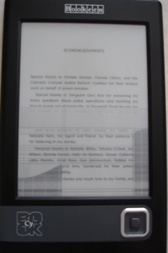

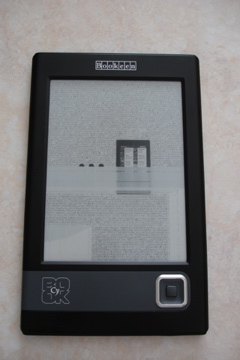

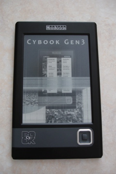

Hi Guys,
Turned on the Cybook this morning and the bottom half of the screen is a mess - lines running through it. Have rebooted & reset and nothing has improved. Now it even has the lines on it when the screen is blanked.
Here's a few pics of it. Has anyone else experienced this? Really don't want to have to send it back for repair!
Regards
Ciara.

I'm afraid that it looks very much like a broken substrate. The screen has a very thin glass layer under the plastic. If you put pressure on it, it easily fractures. It's not repairable - it needs a new screen which will probably cost about two thirds the cost of a new machine - and it's not covered under warranty because it's caused by an impact to the Gen3 or pressure on the screen.
Sorry to be the bearer of bad tidings .

It needs to be sent back to Bookeen, certainly. They can then assess it and ascertain what the problem is. I can only go from the fact that the curved lines on the screen and the displacement of the image do, regretably, look just like those which result from a substrate fracture.

I have to agree with HarryT. It does look like a cracked screen. Even though you cannot seer the cracks, they would appear underneath.
