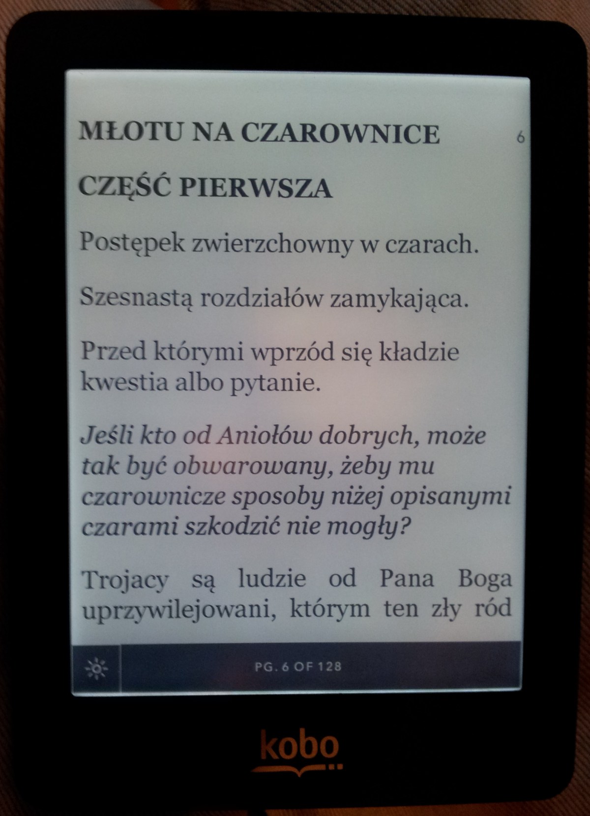

I would greatly appreciate pictures if it is not too much time consuming and troublesome
Pic attached.
Please excuse a funny camera angle, I was trying to avoid glare... Also, font is large because that's what my parents prefer.
The following fonts work:
Georgia (used in the photo)
Gothic MB101
Ryumin
The following don't (show a funny replacement symbol for each Polish character):
Amasis
Avenir
Gill Sans
Rockwell
This is with firmware 2.1.4.
o/

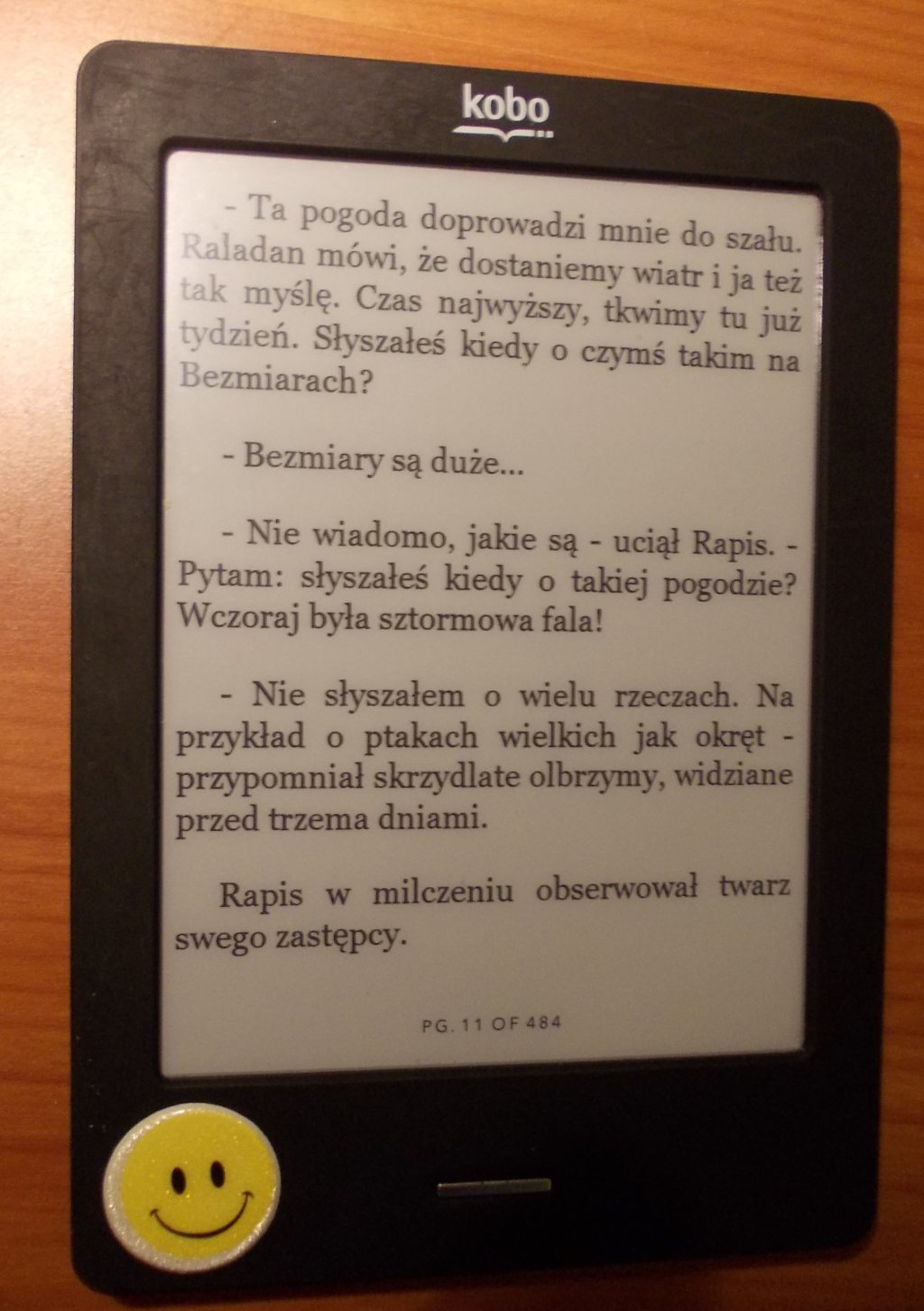

I have a Kobo Glo and have been reading Polish epubs without any problem so far. Example attached.
