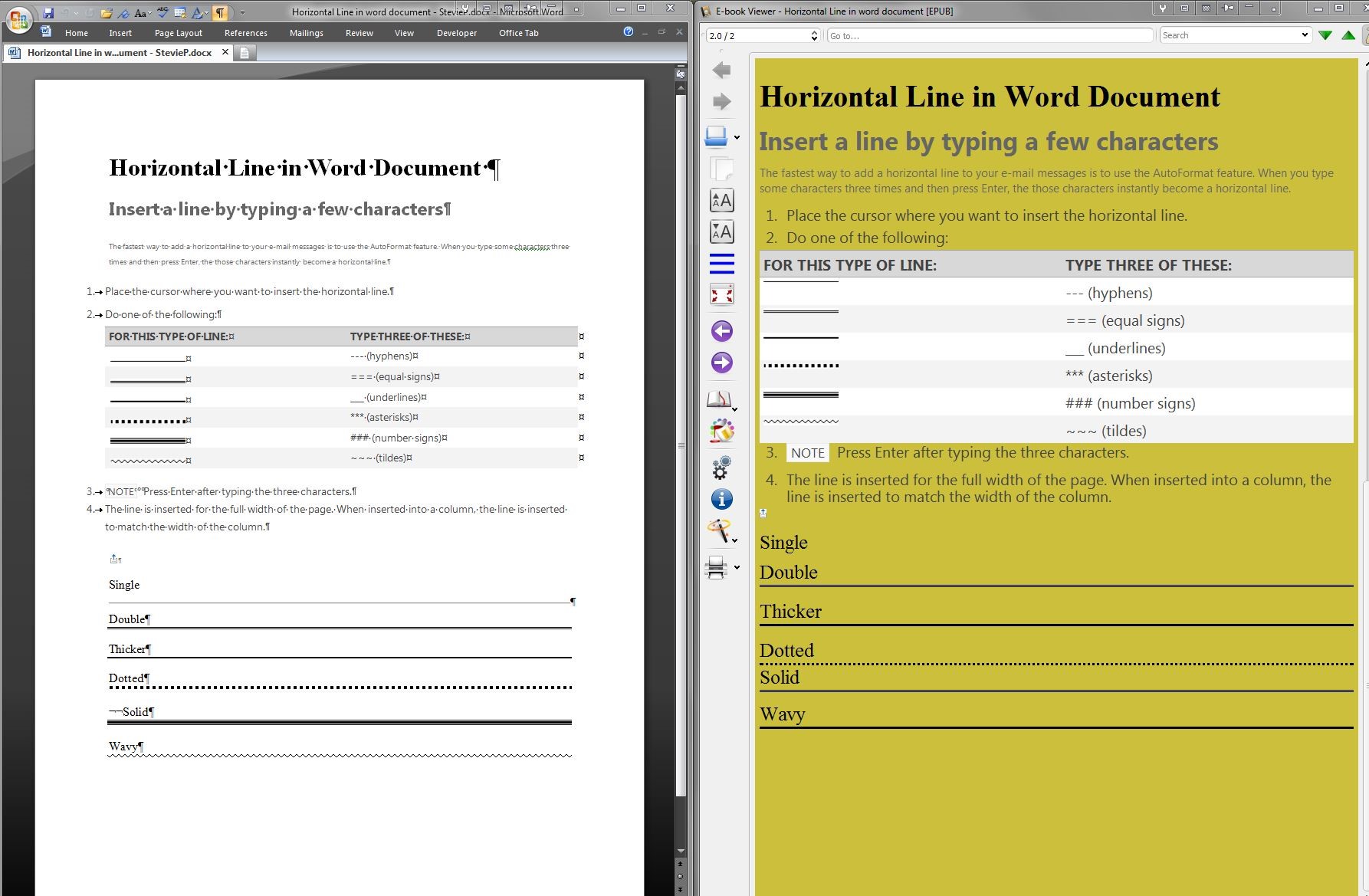

This what the two files look like here, the first single line seems to absent

Sorry I've just looked at my example again more carefully:
The problem is that only the Single line (block8) doesn't appear on the page.
The unfortunate thing is that it is that one I use most.
StevieP is offline   Reply With Quote

Ah, I see now, the Single line is missing, that's probably because its width is too small, html rendering engines refuse to draw things below a certain width, I'll see if it can be fixed.
Old 06-29-2013, 12:29 AM   #12
Posts: 45,617
Karma: 28549044
I had a look, the Single line is represented as a drawing in Word, the others as paragraph borders. The conversion does not support drawings, so the line is missing. I'll see if it is possible to recognize this particular drawing and convert it into an <hr>, it will depend on if Word marks it up the same way every time.
