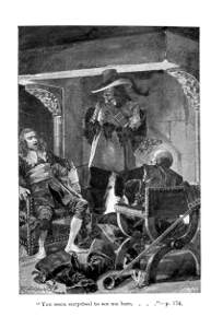

I'm sorry if this is in the wrong forum for this post, and to have to expose my abysmal ignorance about images.
The attached image is from a book published in 1894, taken from the Internet Archive. I'd very much like to use this and ten similar quality images as illustrations in an ebook I'm proof reading now.
My questions in decreasing order of importance are:
- Is the image fixable - can it be improved enough to make it usable?
- How would you describe what is wrong with the image? What needs to be fixed?
- What software would you recommend? - preferably free. I have PMView, Paint, Irfanview, and GIMP 2.8. But I am starting from scratch so far as doing more than sizing and cropping, which is part of my reason for asking what is wrong with the image.
I haven't found anything in the Wiki; is there anywhere else I can get help from?

I don't see actually a lot wrong there. It seems like a grayscale image (although heavy on the black) of a painting. Perhaps a small 'cartoon' filter used additionally.
Perhaps you can find a better image of the original painting? It looks a bit familiar.

It looks like a bit like it has had a blur/despeckle filter applied, but it might simply be old printing technology.
As for advice, I'd fetch the "original", which in the Internet Archive means clicking on "All files", and then choosing one of the largest files, probably one with "jp2" or "raw" in its name. If the image can be improved, it will be from there.

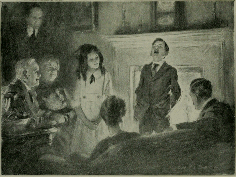

Did you remake this image? It has too few shades of gray. The post internally has plenty of gray shades but the source must not have.
Dale
Yes, I did. I thought it might help to get the pdf and do a snip of the image with the Windows Snipping Tool.
Since Jelby's post yesterday I went back to the Internet Archive. Although I couldn't find a 'Raw' set of files anywhere I did find another version, downloaded the ePub file, and unzipped it to get at the images it contained. Most of the images seem better, but I've attached another image
which seems even worse. The scene is in an inn at night, and to my untutored eye looks awful. I know it doesn't look good, but don't know how to fix it.
I've seen and happily used other images I got from Internet Archive ePub files for other MR ebooks, but they looked a lot better than these.

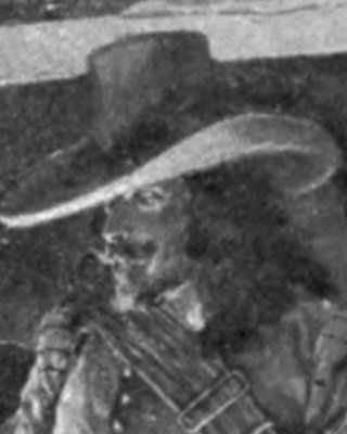

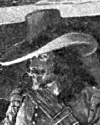

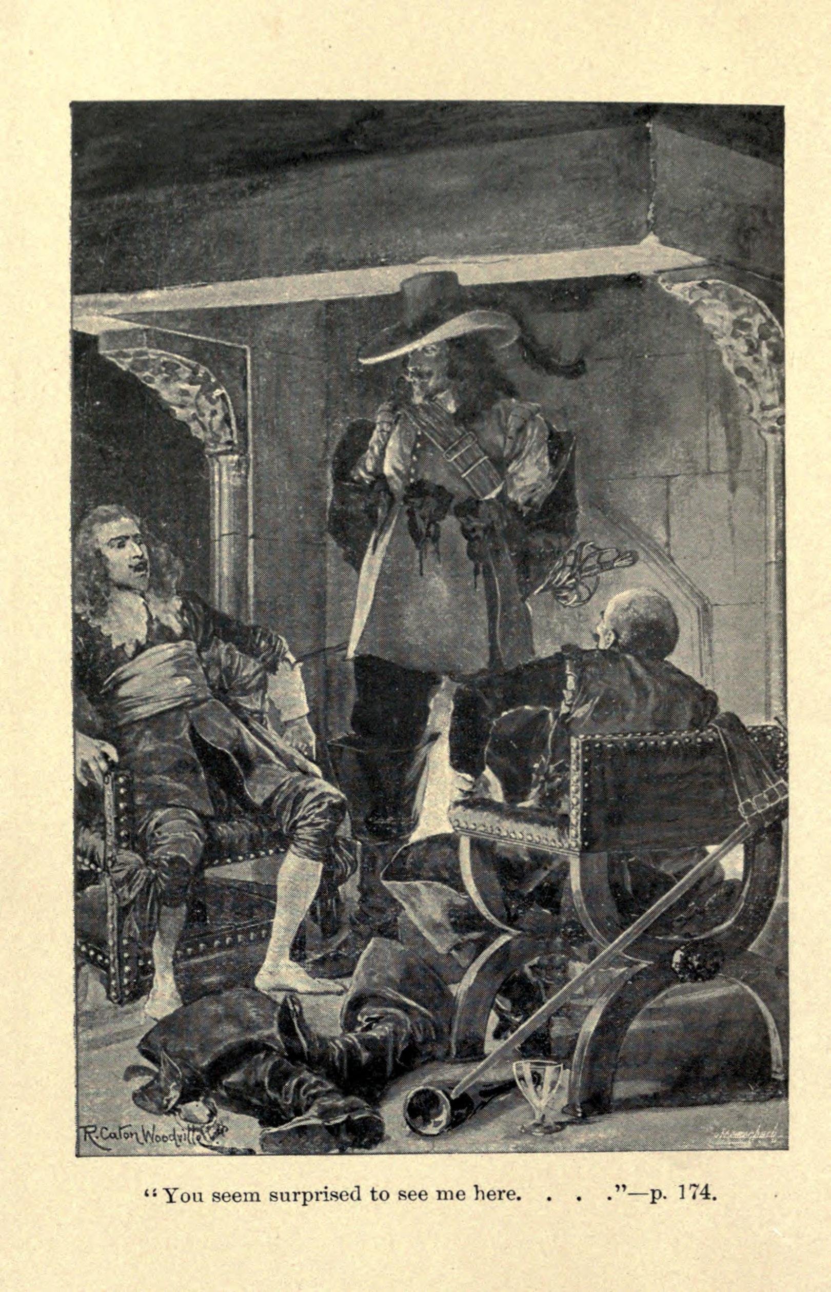

Old 07-02-2013, 06:14 AM   #12
SBT
SBT's Avatar
Posts: 580
Karma: 810184
Location: Norway
What I do:
  • When using Internet Archive, select 'Read online'.
  • If I want to save a page with an image, I right-click on the page, and select 'open in new tab'.
    The image is loaded with an URL like http://ia700300.us.archive.org/BookReader/BookReaderImages.php?zip=/30/items/underredrobe00weymiala/underredrobe00weymiala_jp2.zip&file=underredrobe00 weymiala_jp2/underredrobe00weymiala_0006.jp2&scale=2&rotate=0
  • Change scale=2 to scale=1, and you get max resolution.
  • Right click on image, select 'copy image'
  • Open Gimp
  • Press Shift+Ctrl+V, aka. 'Edit->Paste as -> New image'
  • Set 'Image->Mode->Grayscale'
  • Set zoom to 100%.
  • Observe that in this case there are dots (rasterization?) in the image. They mess up image sharpening, we remove them by 'Filters->Blur->Gaussian Blur' ,blur radius 2x2 pixels.
  • Set zoom to 25% again.

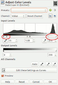

  • Select 'Colors->Levels'
  • In the Popup window, slide the white triangle below the histogram to the left until the paper margin in the picture is white, i.e. to the left of the right-hand peak in the histogram.
  • Slide the black & mid-level triangles until you are satisfied with the result, and click OK.
  • Select 'Filters->Enhance->Unsharp Mask'. This filter accentuates borders between dark and light areas, so it actually sharpens the image.
  • Use default values (5.0, 0.5, 0)
  • Undo & fiddle with values if result is unsatisfactory, or just skip the unsharp filter.
  • If you have wavelets installed in GIMP, you can use it to mitigate the effects of unsharp again When the image is a bit 'blobby', as in this case, wavelets can smooth things a bit. Apply 'Filters->Enhance->Wavelet denoise', in this case Threshold=0.75, Smoothness=0 are sensible values.
  • Select 'Tools->Selection tools-> Rectangle select' and select the image part of the page.
  • Select 'Image->Crop to selection'
  • Now I save the full-size image.
  • Select 'Image->Scale image', and shrink it to whatever size you want for your book.
  • Select 'File->Export'.
  • For images like this, which are slightly fuzzy and blurry, I often set jpeg quality to ~70%.
  • Line drawings I normally save as png, but first I select
    'Colors->posterize' and set levels=16 (Even on colour screens, fifteen shades of gray normally suffice, and it makes for really small file sizes)
The raw/jp2 images are even larger and more detailed, but In my experience there wasn't anything to be gotten by using them instead. Also, they are often not yet aligned, so you'll have to rotate them a bit as well.
When there are many images in a book, I use the Internet Archive thumbnail viewer, note down the page numbers of images, and make a shell loop to retrieve the relevant pages. This is left as an exercise for the reader
ID:	107589   Click image for larger version
ID:	107590   Click image for larger version
ID:	107591   Click image for larger version
ID:	107592   Click image for larger version
ID:	107593   Click image for larger version
ID:	107594   Click image for larger version
ID:	107595   Click image for larger version
ID:	107596   Click image for larger version
