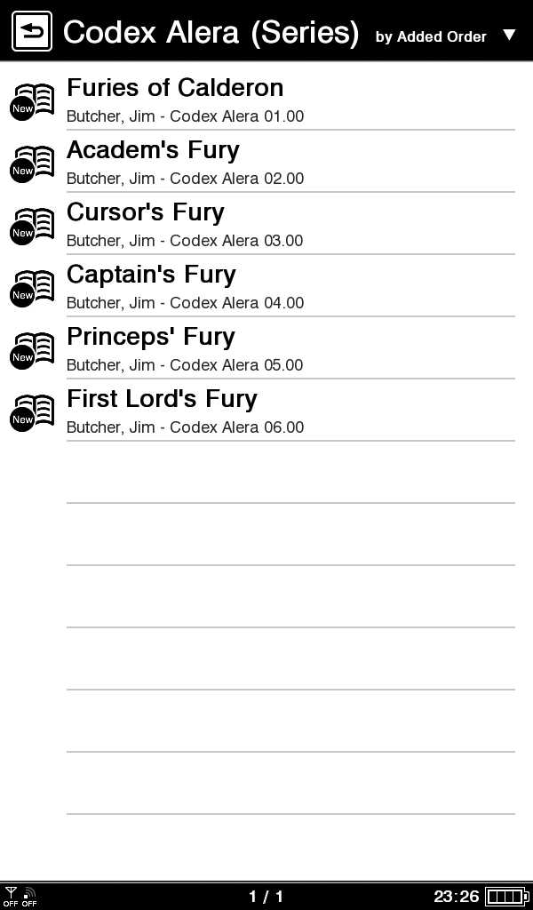

Just curious, what devices are you using? For my Sony devices I include the Series info in the author line and leave the title alone (see attached).

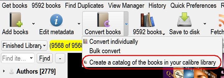

So my question is this - is there an easy way to generate this report?
Create a catalog using the dropdown arrow to the right of the conversion icon (see attached).
Ah, I really like the idea of using the Author line... might consider that for the devices it'll work for.
worked like a dream
