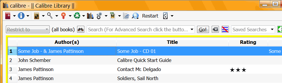

Using a test file and an expression with the above information and everything worked well. (image 1)

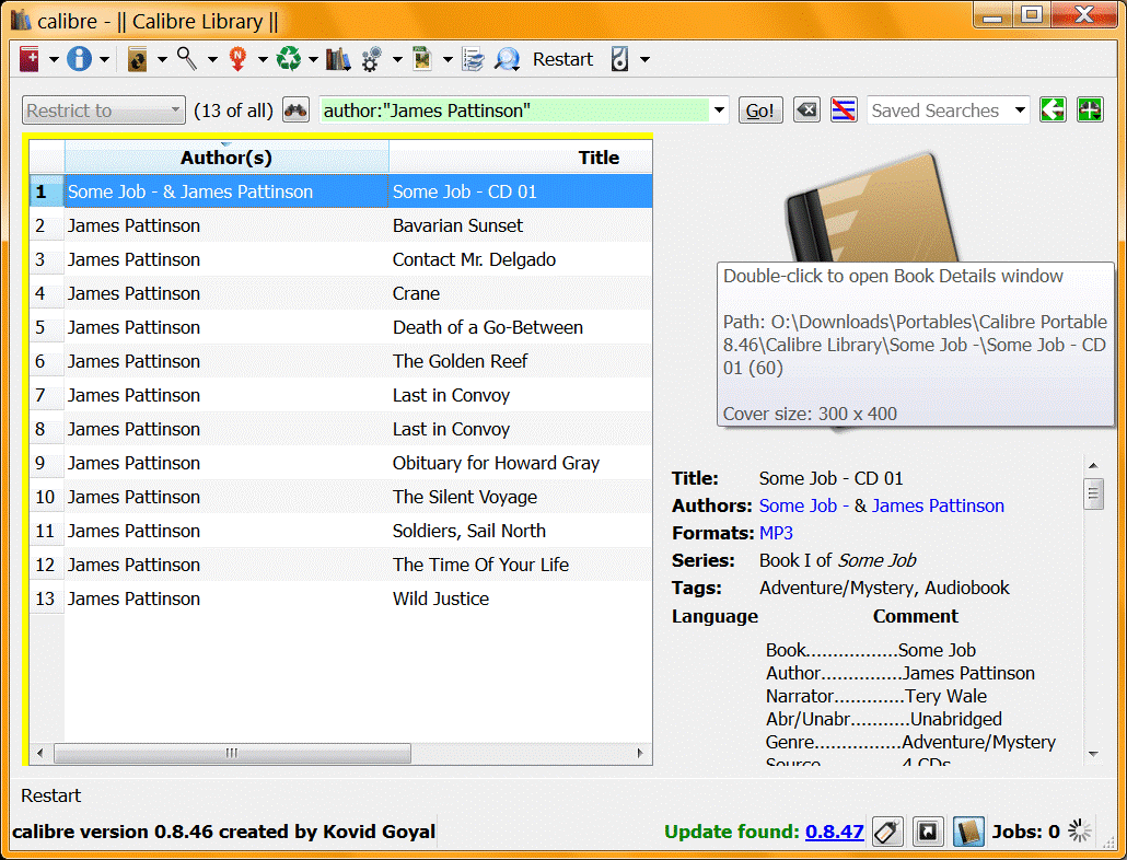

But if I drag-n-drop it doesn't work (image 2)
Am I doing something wrong.
Thanks

Again, it worked in test mode but not in drag-n-drop as can be seen.
Could it be because I'm using d-n-d????
Thanks

Drag and drop is no different to using add. It will use your regular expression for a text file. However I notice you still had "Get metadata from file contents" ticked in a screenshot above, so if you drag/dropped an epub or mobi for instance it is going to use title/author metadata from inside the file, NOT evaluate your regex. If relying on filenames/regex is how you want to do your imports, then untick that other option.
Apologies if I missed it but I haven't seen you post the actual filename of the file you are drag/dropping. I see lots of screenshots of regexes and the result, but not what the actual name of the file is. If your "plan" for the regex was based on a flawed assumption then everyone's suggestions to tweak it aren't going to do any good...

That worked great - I knew I was doing something wrong.
It was the actual file name with the exception that it was an ".mp3" rather than a ".txt" Testing would not allow me to use ".mp3" as an extension.
