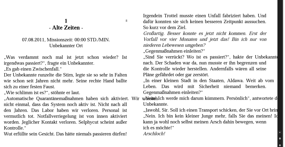

Hey there,
got a problem with epub and ADE.
I use a template for ADE (tried different ones by now, none worked out my problem). Quite often the line break is broken, meaning that words go beyond the point where the line should break properly (and it is breaking wrong inside the same sentence where no special code is placed). See screenshot for what I mean. It looks kinda strange. Actually, the text should be justified, but as you can see, it's not working properly ...
And if I go to full screen, the text improperly aligned is outside of the readable area, meaning the customer would not be able to read the faulty areas.
Btw, the file was not converted using any software, did it all by hand using Notepad ++. I used a free sample epub file to modify and placed my content inside.
Can anyone help me figure out the problem? What could it be?
EDIT: Just noticed it has something to do with speech. Crazy I didn't notice earlier, but it has something to do with speech of characters. But why? "What the hell happened now" for example. It would break up wrong if it was long enough ...

What is the codepage of the Notepad++ file? Have perhaps used non-breakable spaces?

Your text is not properly coded. You are using
<p>Text 1<br />
Text 3<br />
Text 4<br />
Text 5</p>
When you should use
<p>Text 1</p>
<p>Text 2</p>
<p>Text 3</p>
<p>Text 4</p>
<p>Text 5</p>
NEVER use <br />. It doesn't show the same in different platforms.

ok, checked for the spaces - not the problem.
checked for br-codes: working now god, why couldn't i figure it out myself? lol
ok, maybe because i thought it was deeper in the files instead of this simple thing. NOW IT WORKS (and needs to be changed)
THANKS FOR THE HELP!
