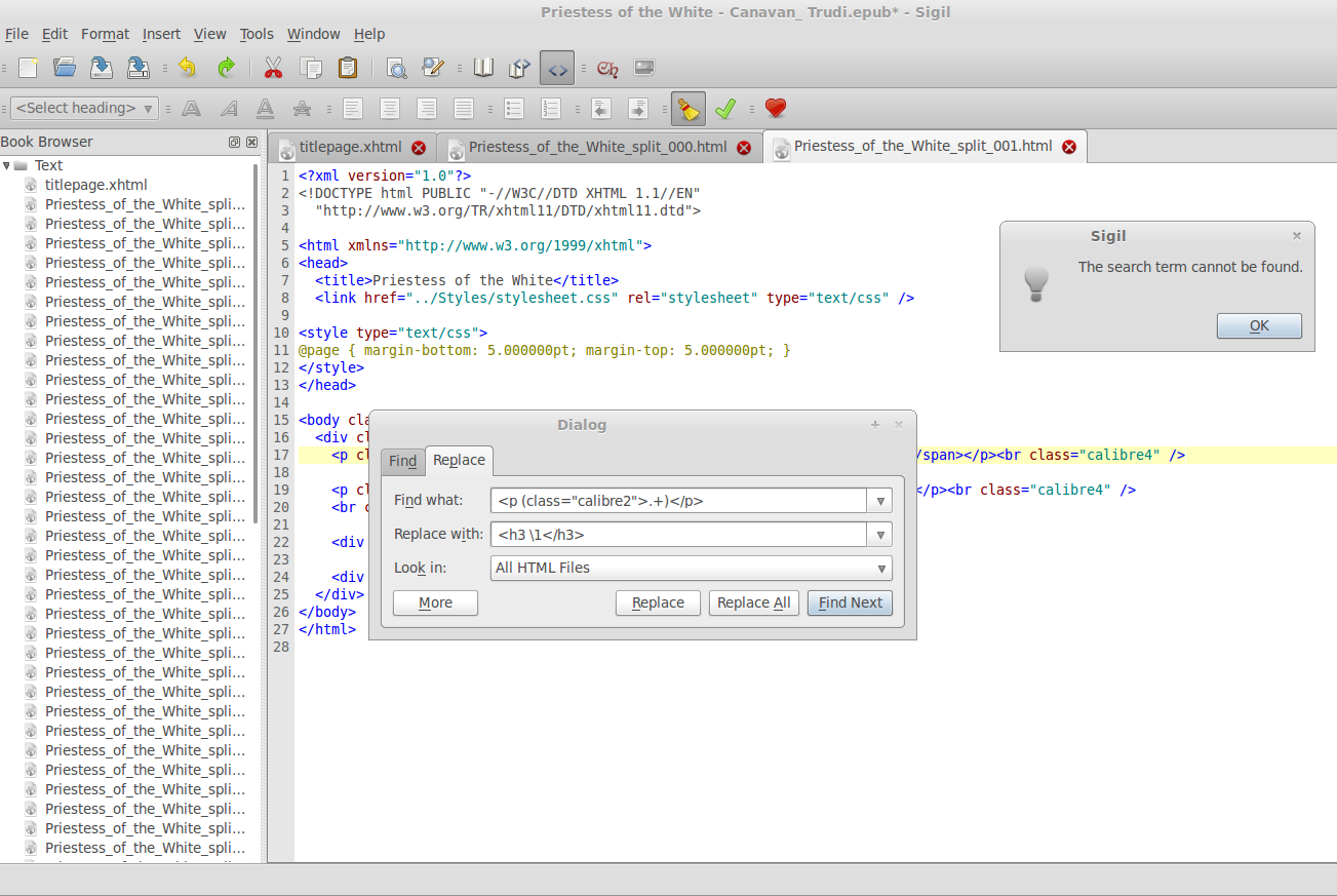

I'm not sure what I'm doing wrong, but I'm still not getting it. Now it says that your "find" pattern doesn't exist in the book. I've attached a screenshot showing my work in Sigil, if you would be willing to take a look and see if I'm doing this correctly. Thanks for the help!

look close. you are missing the ( before the .+
because it was not a pair, it looked for something with a )</p> which is not there
Patterns are exacting

Could you please type out exactly what should be in find? I copied/pasted the expression from your first post so I am unclear exactly what I should be using. Once again, thank you for the help.

The original find I supplied is correct
Use the corrected replace
