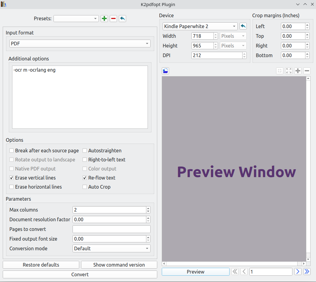

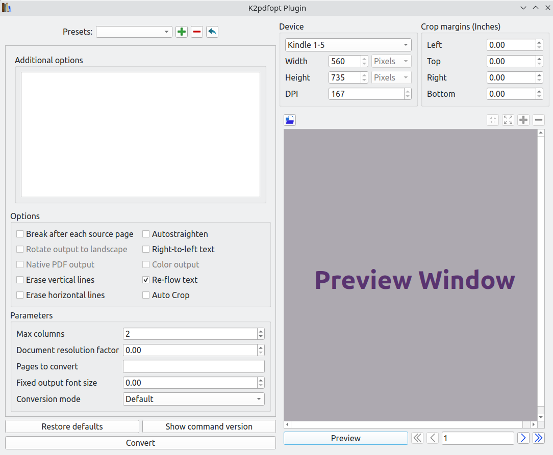

[GUI Plugin] K2pdfopt Plugin
This plugin used k2pdfopt program to convert PDFs to an optimized version that can be read on ereaders
How the plugin works
  • Select book(s) you want to convert and click on the plugin icon in the main toolbar. It should open a dialog with conversion options.
  • Choose the options you want and then press preview button to see how it would look on a sample page.
  • To convert the book(s), press the convert button.
  • Calibre job(s) will be launched to carry out the conversion in the background, after which it will prompt the user to add the converted books to calibre.
  • The newly converted PDFs will be added to calibre, depending on the user settings as follows:
    1. [Default option] The converted book is added to the same book record as a PDF format, while the original file is renamed into an ORIGINAL_PDF format.
    2. The converted books is added to a new book record.
Modifying metadata of added books
  • When the converted books are added to calibre as a new book record (as opposed to the default option of adding it to the same book record), an identifier in the form of hex_library_id/source_book_id is inserted into the new record. You can use this in conjunction with calibre's identifier rules to create a link to the original book (using calibre's URL scheme)
  • The plugin provides an action that will be available in Action Chains plugin if you have it installed. Using the two plugins together, you can modify the title, tags or any of the metadata of the newly created books to your liking.
Notes
  • This plugin uses a third party tool called k2pdfopt. For the plugin to work, you must have the k2pdfop binary available on your system path. If not, you will have to use the plugin configuration to specify the path to the k2pdfopt binary. Note that you must make sure the binary have all permissions necessary to run, otherwise the plugin will not be able to function.
  • This plugin is implemented as User Interface Plugin, and not as an output (conversion) plugin. Calibre conversion pipeline necessitates converting the input format into HTML, which does not work on this case where the conversion is from PDF to PDF without any intermediary format.
  • The plugin interface tries to adhere to the GUI of the original program whenever possible, but there are still some differences and omissions.
  • The plugin comes with a preview window to examine the settings on a sample page of the PDF file before conversion.
  • The plugin comes with the ability to create and store custom presets with different settings.
  • For options that does not have a GUI element, you can specify the corresponding command-line argument in the additional options text box.
  • To get a help on a any option hover over it to display the associated tooltip.
  • Action Chains plugin have an action called (save/restore formats), that gives users the ability to change format extension, in case you want to restore ORIGINAL_PDF to PDF.

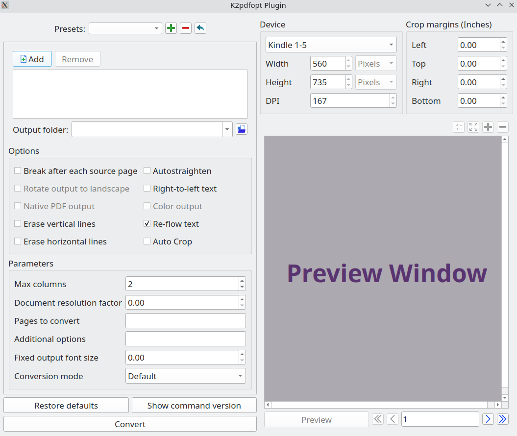

Running the plugin outside calibre
  • You can run the plugin outside calibre to convert PDFs on your filesystem (outside calibre) in much the same way the original k2pdfopt can be used on Windows. This can be handy for users on linux and osx as both OSs do not have an official GUI. To run it use the following command:
    calibre-debug -r "K2pdfopt Plugin"

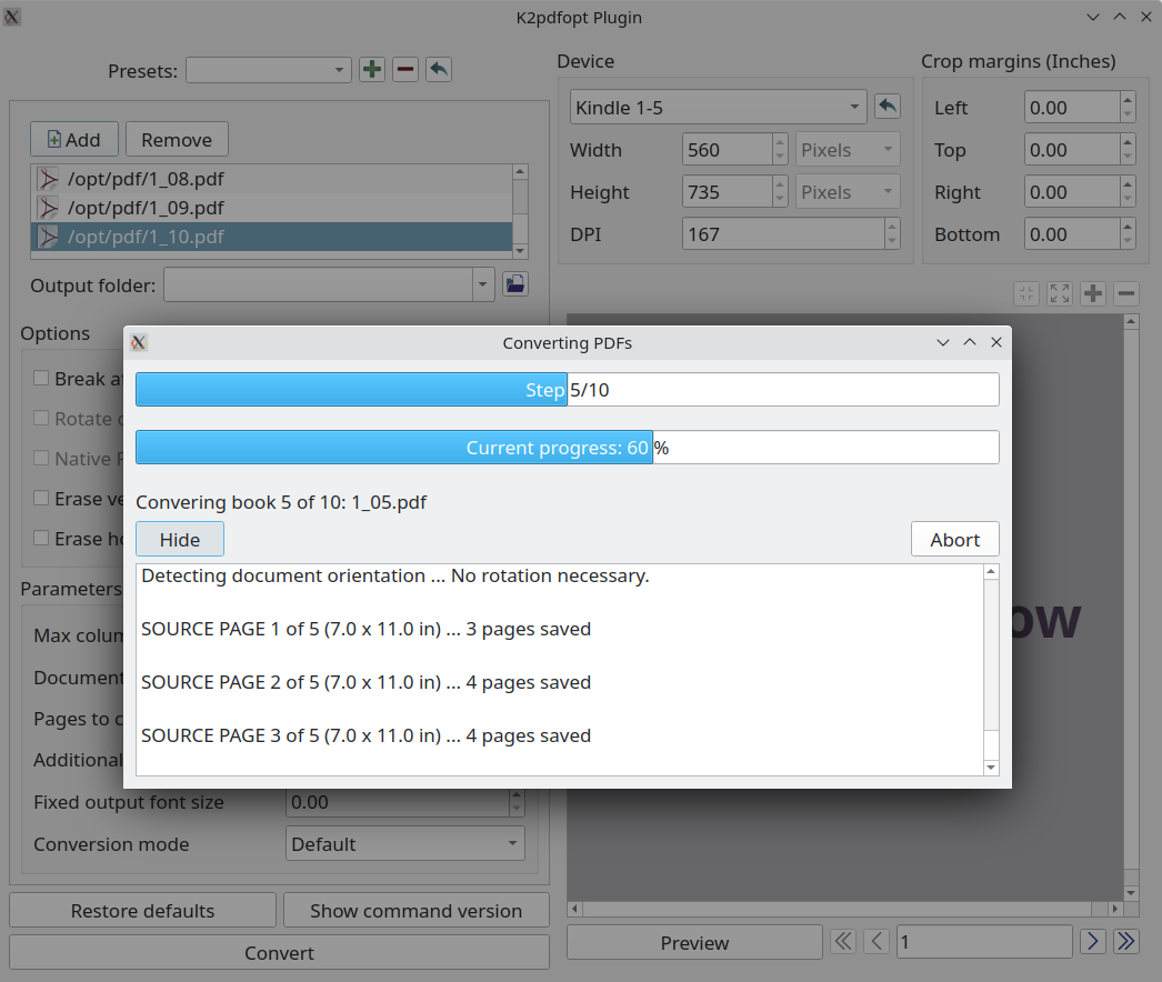

Jobs overhaul. Shift to all threaded jobs. Jobs can now be aborted mid-conversion and show progress properly.
Page count by querying k2pdfopt without having to use any third party utils.
Stand alone version: Double progress bar to show overall progress as well as each book progress.

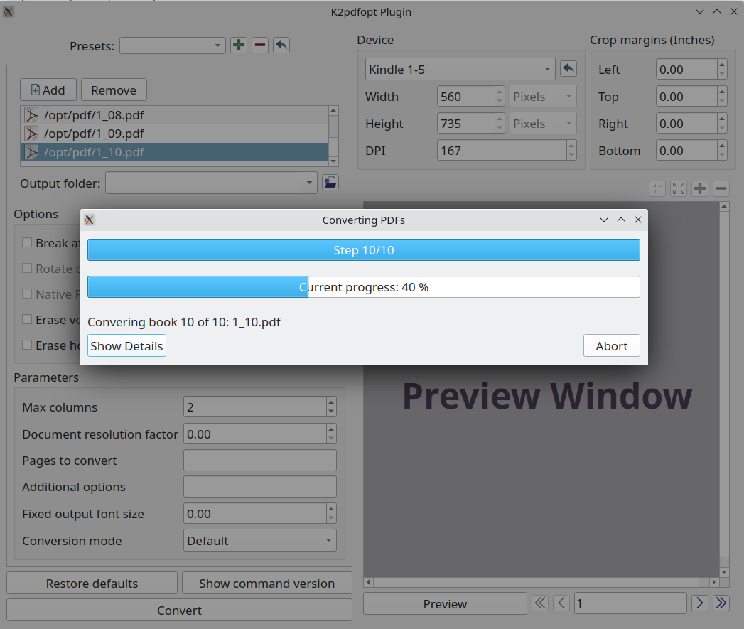

  • Jobs overhaul. Shift all to threaded jobs. Jobs are invoked individually for each book so that they can be aborted mid-conversion and show progress properly.
  • Page count by querying k2pdfopt without having to use any third party utils.
  • Stand alone version: Double progress bar to show overall progress as well as each book progress. Also enable abort mid-conversion instead of waiting for the current book to finish.

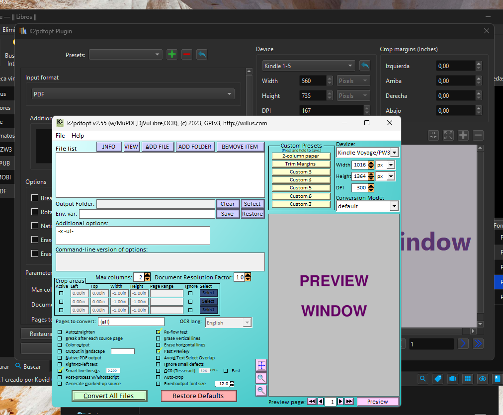

hi, i'm having problems.
i don't the binary part. i downloaded the .exe form the web and put it in "Choose binary".
Now every time i click the plugin icon it opens 2 windows
it does that to me too, plus it doesn't seem to use OCR option in the k2pdfopt program 2.55 version of the program I have downloaded of the x64 binary type. it was at first opening it two times, if you click on the plugin, it opens it then once that window, click on the convert button it reopens it again. so that is two times.
its missing the plugin does seem to be missing settings that the program has like that OCR (Tesseract) feature it has within the program itself the plugin is missing that and its missing Fixed output font size, which I am not sure that even works or not, I don't really know if it affects pdf fonts in the images at all, but without OCR on the pdf files cannot use in edge and read aloud feature doesn't work for pdf without having OCRing the pdf , which does work well with pdf and text to speech, for me, it's one of the few OCR apps that seem to work well, it's a nice idea this plugin but I do think it needs work I guess.
I have x64 version of Calibre 7.5.1 and the 32x bit version calibre-5.44.0 for the text to speech voices that don't show up in Calibre's Ebook Viewer on the x64 app, both seem to work fine together, this plugin was added in 7.5.1 build of Calibre software, I am guessing the person who also has it installed is using the current version too on their pc.
I had to manually setup a save for Presets: Default profile, as it didn't come with a save value and each time I open k2pdfopt Plugin I have to reopen the Default profile, otherwise it doesn't remember my settings when the plugin is opened, that might need to be fixed in future builds, again I like the idea of this plugin it just needs some updates, looking forward to seeing its progress, and thanks for the plugin
https://www.willus.com/k2pdfopt/
https://www.willus.com/k2pdfopt/download/?-1
https://willus.com/k2pdfopt/contrib/
So, I tried that k2pdfoptgui 2.0 from k2pdfoptgui2_1_0_0,zip from contrib website it seems to get this message with the official 64bit downloads, it doesn't seem to want to output a pdf from that software? ok I think it doesn't work since it was last updated Last update: v2.1.0.0, Jan 2014 which is older than k2pdfopt.exe 2.55 version, I guess that makes sense why it doesn't work anymore, not sure why there is still a link to it on that page?
[01:20:59] WARNING: k2pdfopt.exe file size mismatch.
Conversion might not work properly.
[01:20:59] Conversion process started...
- I just found this from the link in the original post, anyway 2.55 is current but second mirror site only has 2.54 app, so its downloads I guess are a bit older since current version is not on the mirrored site for this app. this link has alternative gui I just found this, I been only using the one gui, I have to try this out, again thanks for that link I didn't know their was a post here about it too.
https://www.mobileread.com/forums/sh...d.php?t=144711
v2.55 (December 26, 2023) windows 64bit app, and it has the gui in it, not sure if their a console only version as I don't see it on Willus.com's K2pdfopt Download Page, I am pretty sure this is the correct homepage for K2pdfopt app, I don't see a console only version, I am not sure if this plugin is looking for a console only version, is their a github page for K2pdfopt that might have a console only version of it? anyway again thanks for the plugin
Also, this is a good read below on OCR and tesseract, which might be helpful.
https://www.willus.com/blog.shtml?tesseract_accuracy
one thing I am not sure about when it comes to tesseract is done k2pdfopt 2.55 default to using Tesseract v5.3 "best" or is there a setting somewhere you need to tell it to use, also is the newest version the best when converting pdf files that don't have OCR in them? since the click on box doesn't have much of the way of settings for OCR besides 50% CPUs and Fast button, I noticed that clicking on Fast button seems to make it better for pdf files and edge's read aloud feature, otherwise if Fast is not clicked on its not better at reading back words, I am not sure why this is, since I would think Fast is a lower quality but it seems to help it to read some words in some pdfs files, for me at least I had noticed that.
I am running this software on a 12th Gen Intel® Core™ i9-12900K processor, that what's in my pc if that info helps at all.
The latest installer can be downloaded here: for this I just found this windows installer, I don't know if k2pdfop will use the tesseract if installed or if it only uses its own built in one, since I didn't have it installed when using the OCR option in the app, ok I might of installed it but I forgot that I did already have a version installed does k2pdfop use this directly or does it use its own version?
tesseract-ocr-w64-setup-5.3.3.20231005.exe (64 bit)
https://digi.bib.uni-mannheim.de/tes...3.20231005.exe
https://github.com/UB-Mannheim/tesseract/wiki
https://valid.x86.fr/sgnydq
Last edited by KindleAZWorKFX; 02-17-2024 at 05:26 AM. Reason: added more details & links. good plugin and added features from the original app, that it accessing like OCR. links
When I tested on Windows this did not happen to me. Anyway I uploaded a version that adds an additional switch to suppress GUI (-gui-). Please test and report whether you still have the same problem.
Originally Posted by KindleAZWorKFX View Post
its missing the plugin does seem to be missing settings that the program has like that OCR (Tesseract) ...
You can use the ocr option by adding the following arguments in the Additional options box (see attached screenshot):
-ocr m -ocrlan eng
This will be saved along other options in your preset, so you will not need to re-type it every-time. Make sure to change the language according to your needs.
You can use any other command line option you wish in the same way.
