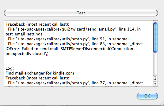

Calibre wont send to kindle but will send to my email
Here is a screen shot:
i'm getting this on test as well as in my attempts to send actual files. It works fine when I change the "to" email to one of mine and not xxxx@kindle.com

oops here is the screen shot
just learning this forum...sorry

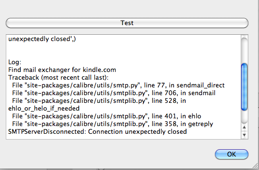

And here is the rest...
Here is the rest as i scroll down...
Everything is set at amazon in regards to email accounts to receive.

you're using a direct send without a relay. Amazon doesn't allow that. Setup gmail based sending.
