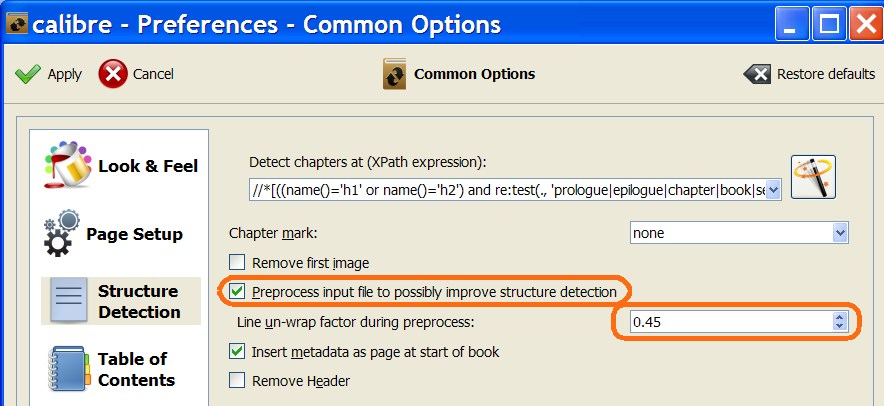

Try converting the lit files with preprocessing checked under structure detection (see attached).
