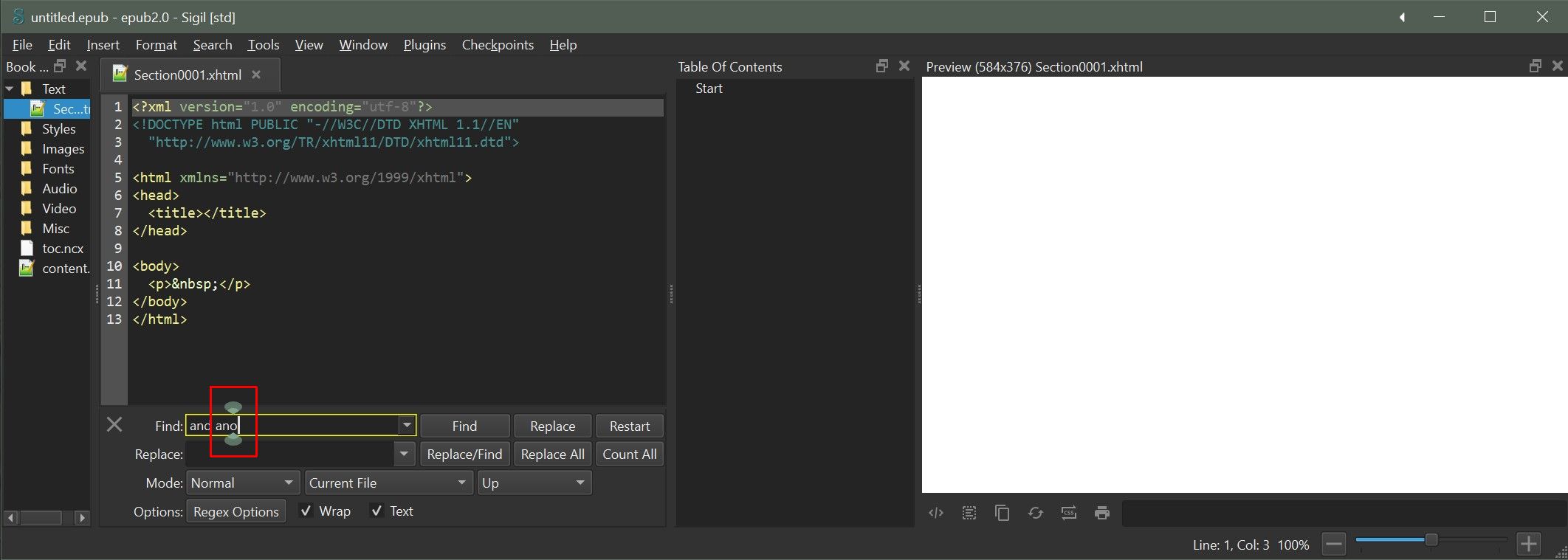

Hi, I'm using sigil 2.3.1 on Windows 11.
When inputting Korean text to html or css, there is a problem that the text are grayed.
When I move the cursor, the text I typed is displayed normally, but this problem is interfering with my writing.
Does anyone know how to solve the problem?

The current line is highlighted in yellow (you control that color in Sigil Preferences). Have you enabled tag matching pair highlighting?
Your text cursor does not look correct (like a Qt generated cursor). It is almost like a third party cursor is being overlaid.
What happens if you try entering latin chars? Does the same grey appear?

1. Yes, that option is active.
2. No, the problem does not appear when entering latin chars.

I see the same grey colour in both. Exactly what is wrong in your first image if it is not the grey?
Please try turning off the Sigil Preferences to highlight matching tag pairs. Does the issue still happen?
What font are you using? Are you sure it is a real monospaced font?

The monospaced font I use is Courier New.
Also, I turned off that option, but the problem still appears.
When I type Korean chars, they are not displayed in real time and are grayed out, making it inconvenient to check if I have entered the correct char.
But, there is no problem when entering Latin chars.
Would you like to see the video I uploaded? You can check the problem I mentioned.

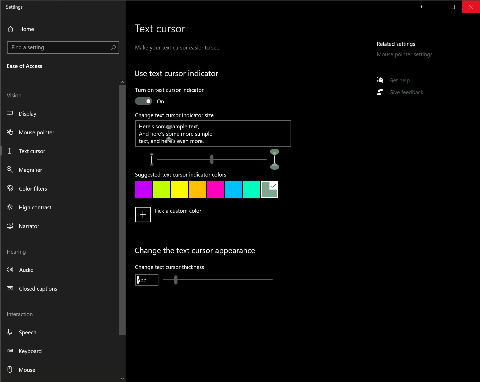

As I said your cursor is not a Qt curser so you have some system extension overriding the cursor.
FYI: Windows 10 has Text cursor tweaks in its Ease of Use Settings that don't work too well in the CV window… see attachments. I doubt Win11 has anything less.
If/when the 'glitch' in CV bothers me I turn the 'text cursor indicator' off.
If the OP has it 'on', I suggest they try turning it off.
Name:	Cursor Settings.jpg
ID:	211688   Click image for larger version
Name:	Cursor in Find.jpg
ID:	211689   Click image for larger version
Name:	Cursor in Codeview.jpg
Well... I already have that option turned off.
