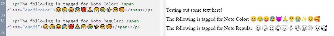

Thank you!! I'm not a coder and didn't spot the errors, so it was very helpful to have them pointed out. I corrected the errors and checked everything again. New result: Noto Color Emojis still display as blank spaces, but with the revised tagging, Noto Emojis display correctly!
And how it appears on my Kobo:
Happy to have this working for now. I will go through the main text and set it up the same way so it will display emojis where they occur.
