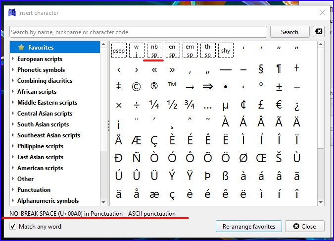

You can find them in Calibre from the Insert Character box...
