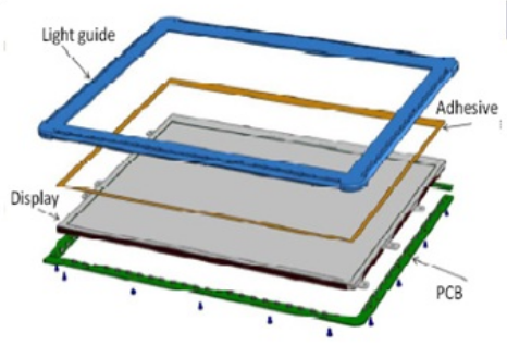

I hope these drawings will help you understand what I'm talking about. The Aura H2O is quiet the stack of layers. For the touch screen to work pcb and light guide have to be lined up perfectly, but they are not connected directly to each other. That is what makes changing the screen so difficult.

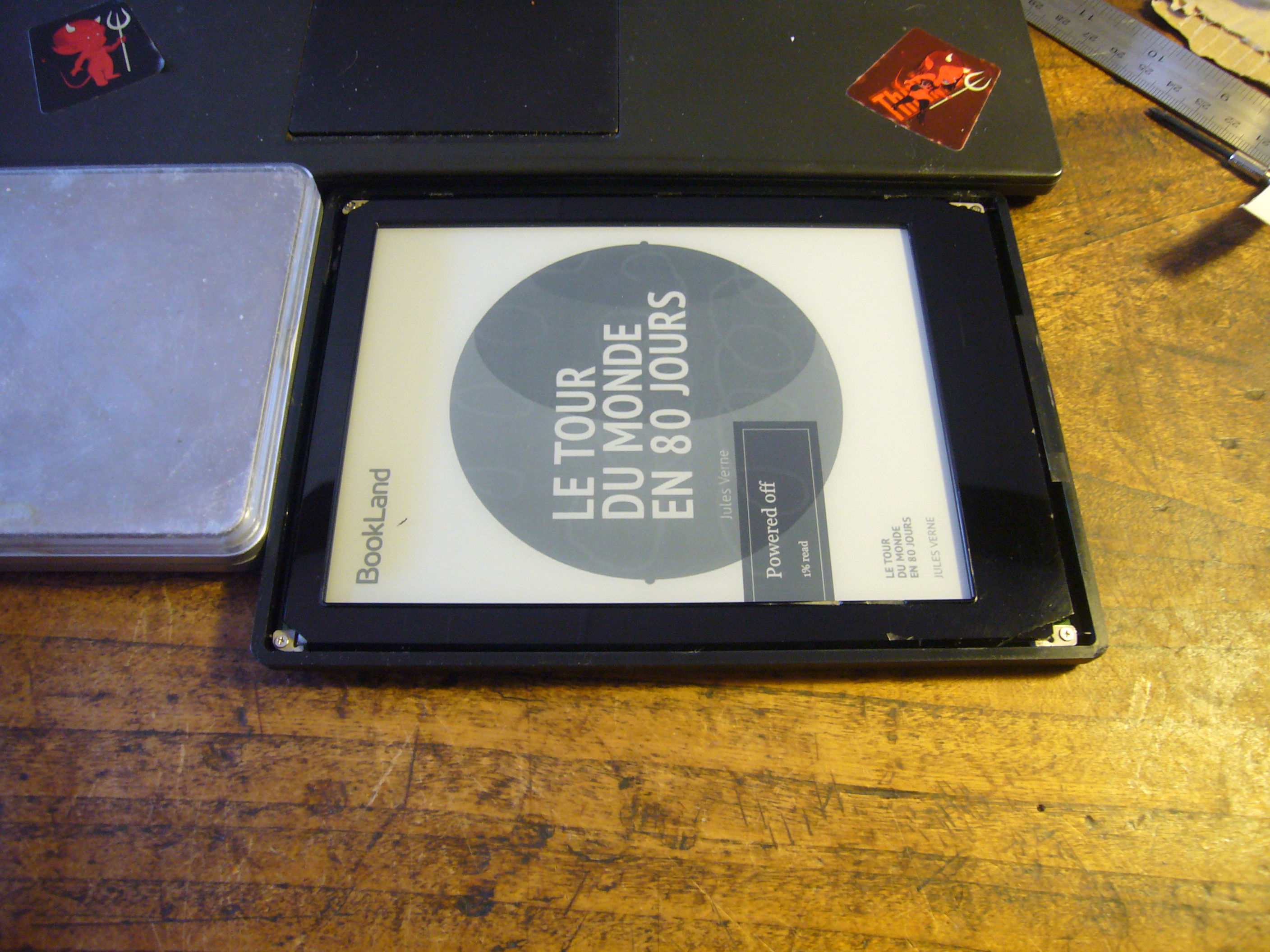

1. Gently heat up the front cover all around to soften the adhesive. Use one hand to feel the temperature as you go. Before the front cover gets too hot to touch it with your bare hand switch off your heat gun.
2. Try to find an opening between front and back cover with your thumb nail or plastic card. Make your first opening all around the outer edge of your reader. You only need to go 3-4 mm deep to split front and back cover. It won't come off yet. That's normal and will only happen in the next step. You might get stuck as the adhesive cools down again, so add some heat.

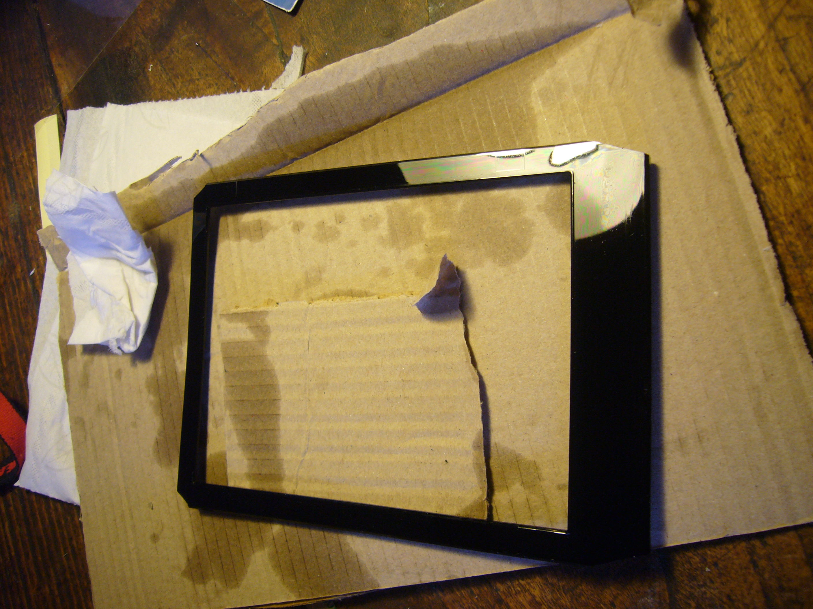

3. Heat the front cover up again. Go around the outer edge for a second time. This time you will need to reach further inside. You need to push in between front cover and light guide (aka bezel, but I'll stick with light guide) until you reach the bump of the light guide. If all goes well you end up with the front cover completely removed.

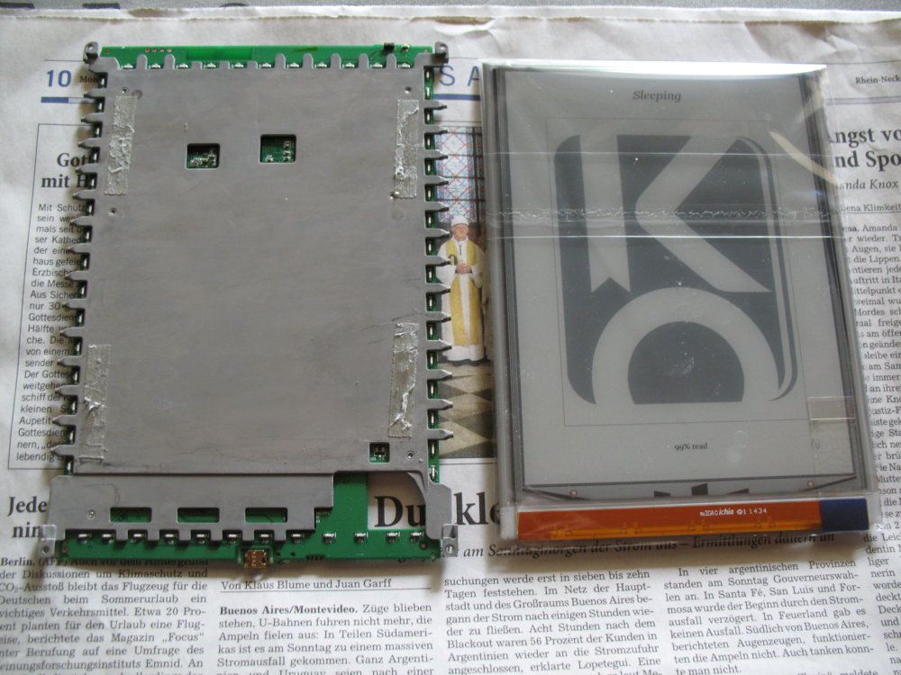

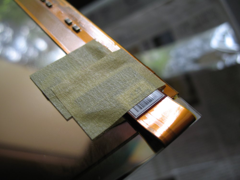

4. Now it's time to remove the light guide from the screen. You need to work from the inside out, sliding your tool between light guide and screen. Start at the bottom of the screen were the adhesive strip is the largest. Apply heat if necessary, but be careful the light guide is fragile. Try to lift it evenly on all sides, keeping it horizontal. There are very small plastic pins on the four corners that you don't want to break off. Once you are done you'll have the bare screen in front of you.
5. Take out the screw in each of the four corners and lift up the screen / pcb assembly. Lift the top first and drag the bottom behind to work your way around the usb connector.

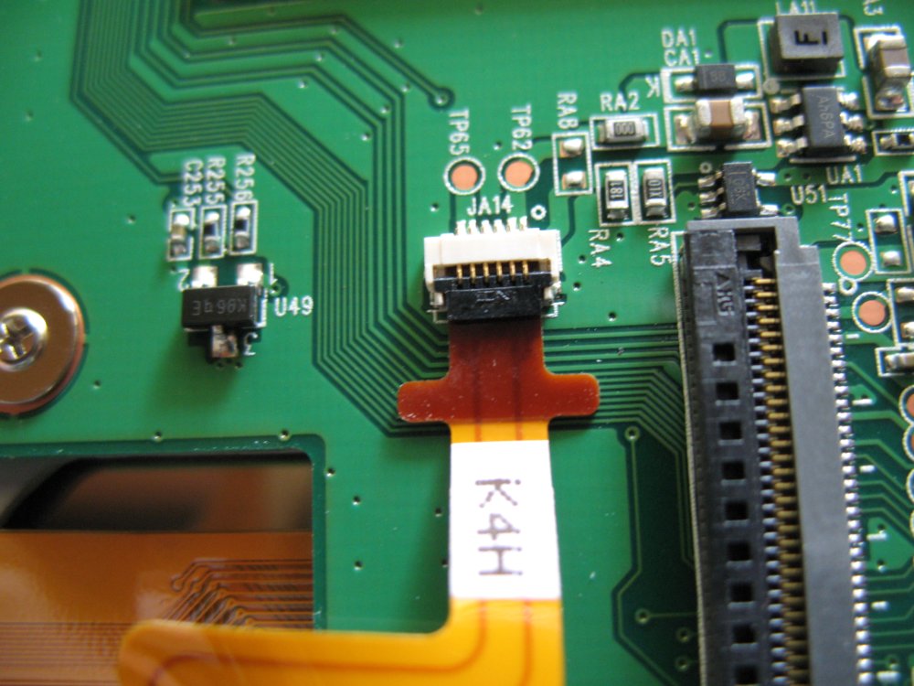

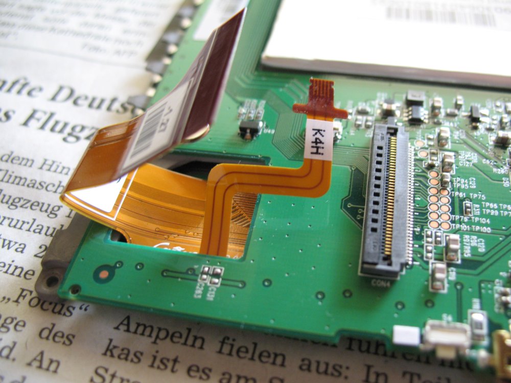

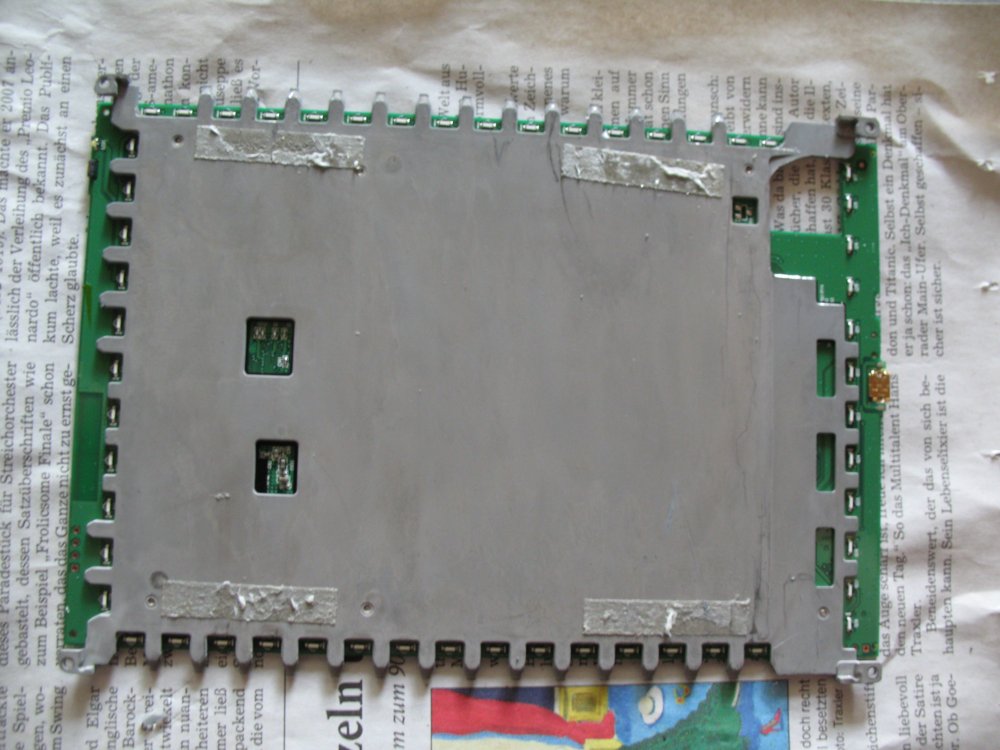

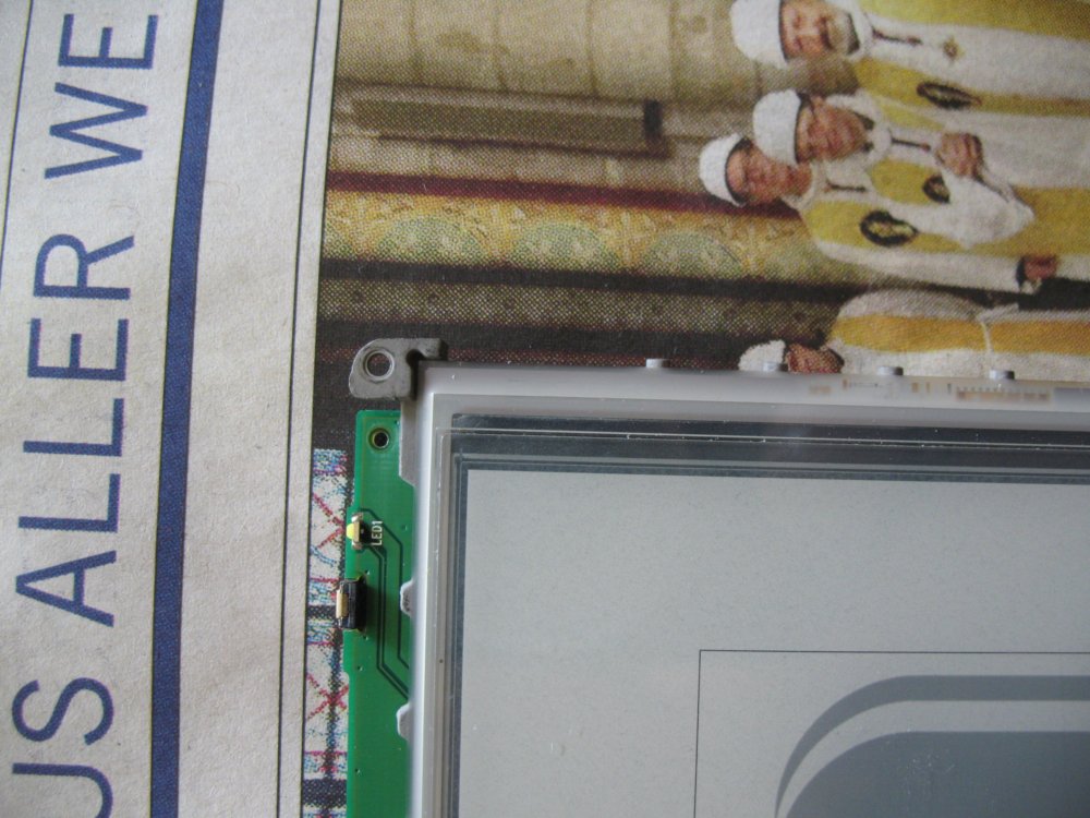

6. Turn the extracted part around to face the pcb. disconnect battery, screen and front light. the battery disconnects by gently lifting the back side of the connector. The screen is the largest connector. You need to lift the plastic squeezer at the back of the connector, the you can pull out the ribbon cable. The front light connector is just under it and works like the screen connector. You can change the screen without disconnecting the battery, but I find it much easier to clean everything after completely removing the pcb.
7. There are 6 screws holding the pcb to the aluminum back plate. Unscrew them and take off the pcb.

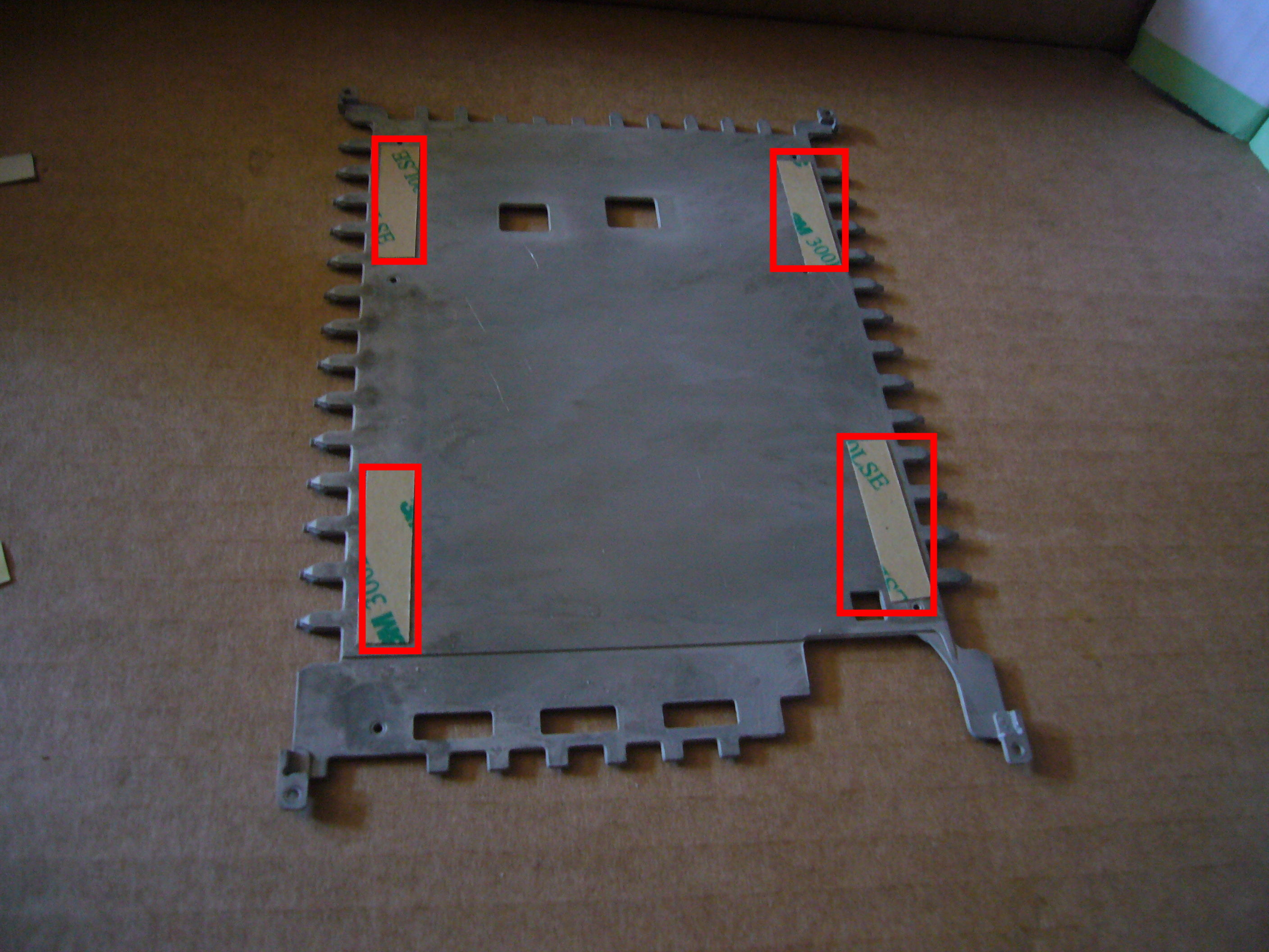

10. Now it's time to put everything back together. I made a cutting guide (h2o adhesive frames.zip : make sure to print the pdf at 100%) to get all the necessary shapes of adhesive out of a single A4-sized sheet. You might get away with strips of tape of different sizes. But after trying that first, I think it is a weaker connection and may not last long. My initial goal was to make the reader water-proof again, which only works with uninterrupted tape. Rumors about additional nano particle treatment kept me from drowning my newly-repaired H2O (1st gen.). Maybe someone knows more about that ?
11. Print out the cutting guide, glue it on a sheet of A4-sized 3M 300LSE double-sided adhesive with glue stick or spray glue and cut it out with a blade or an exacto knife. I made everything a little undersized to have some wiggle-room, but that is to make it easier to put the tape correctly on the parts, you still need to cut them precisely on the line. If you don't want to ruin your sheet of adhesive on your first try, make a test run with paper. Cut everything out and see for yourself. That helped me a lot.

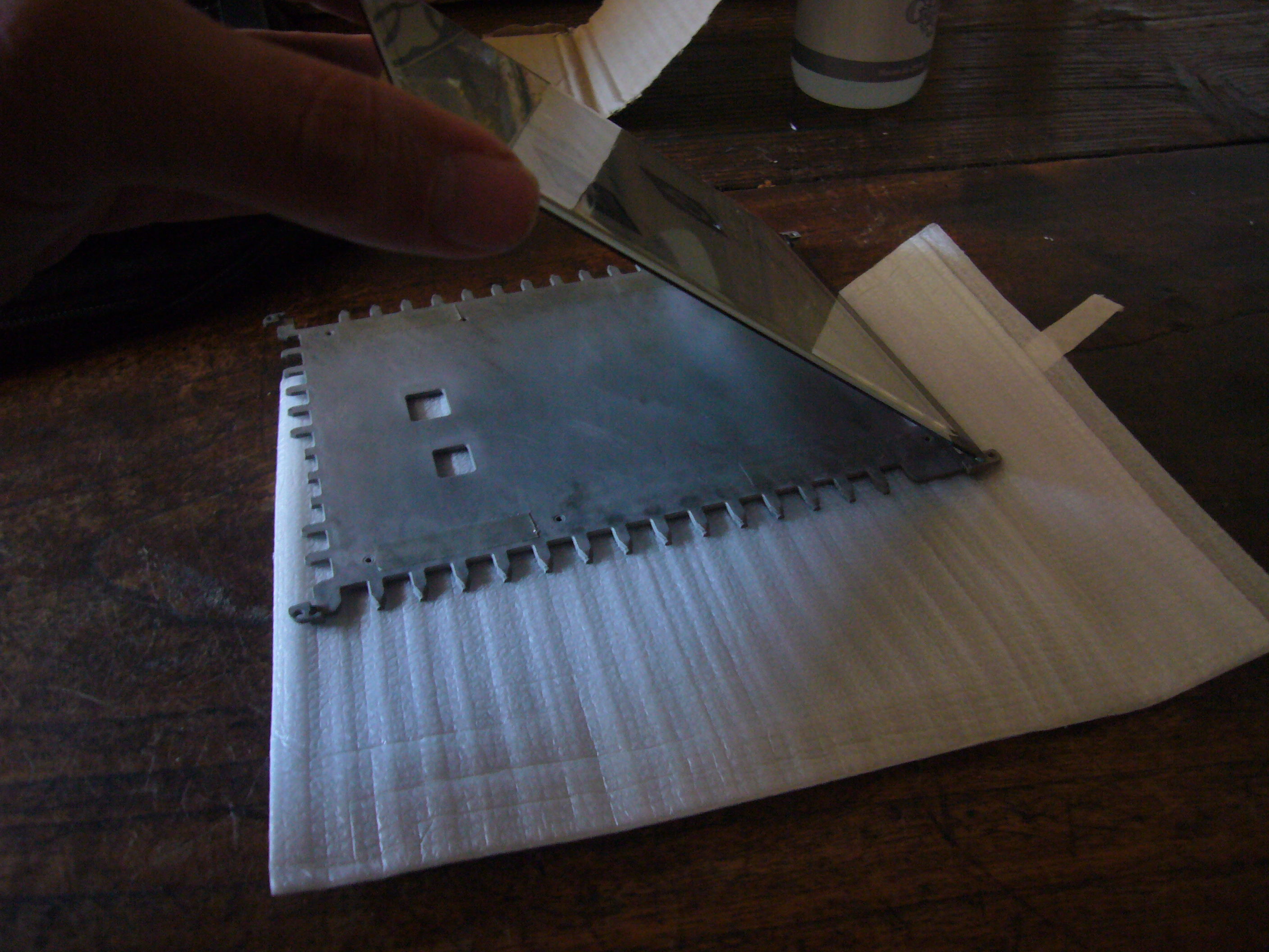

12. Now that you have all the adhesive ready, start by putting it on the aluminum back plate. Before pulling off the protection from the other side of the tape put your new screen on the plate to get a feel for it. Pay close attention to how you are planning to route the two ribbon cables. Both need to go to the back side of the aluminum. What works best for me to position the new screen, is to put in the two bottom corners while the rest of the screen is still at an angle. When the cables are where they belong push the rest of the screen in like a door, aiming for the two upper corners.

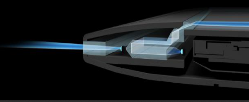

One last thing : the infrared touch screen is quiet interesting. Definitely longer-lasting than its capacitive / resistive counterparts. Kobo seems to have abandoned it tough...

After digging around the internet for quiet some time I found a research paper about Neonode, the company selling the ir touchscreen technology, their technical support page and two of their patents. I'll leave you the links if you're interested. This information eventually made my repairs possible.
https://ijcsmc.com/docs/papers/Septe...V2I9201321.pdf

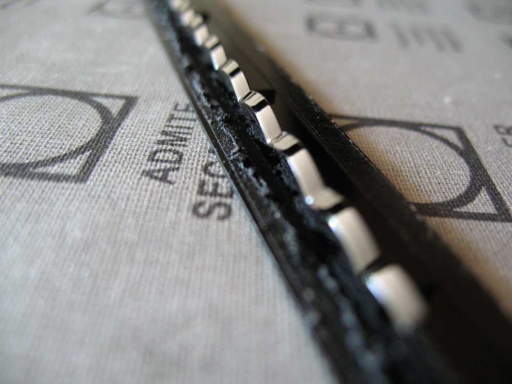

@hatteras Nice posts! Would you know what wavelength the IR LEDs use. I couldn't find it in the docs from further reader.
I have already fixed the screen of my Kobo Aura H2O. But the touchscreen had a problem with a column on the left. It turned out to be a missing infrared diode (IR LED side SMD). Still trying to pin down what wavelength the photodiode receivers use. Apparently, 850 and 940nm .
Unfortunately, the size of the diodes has changed over the years. My old pocketbook and Kobo Aura HD use a larger IR LED, otherwise I could have soldered that one onto my H2O....probably, still going to try that.
EDIT: It's working again!

Sorry, didn't have any info on the ir diodes. I managed to see them glow under the camera of my phone back when I was still trying to confirm that the touch screen actually uses infrared light, if that is of any help.
I found this post on 840nm vs. 940nm https://www.eevblog.com/forum/projec...gth-of-ir-led/ :
"840nm and 940nm are common wavelength values used for IR remote controls. It is easy to differentiate between both, because you can see 840nm slightly glowing in the dark, but 940nm is virtually invisible.
You can verify the LED is active by using a digital camera: The LED should be visible as a white or purple spot."
Same here : https://ellipsesecurity.com/2018/05/...r-illuminator/
But I did not actually build a test circuit to try that out. You were using older, larger leds for your repair ? Did I get that right ? Took a picture by any chance ?
hatteras is offline   Reply With Quote

Thanks! That is a practical approach! I'll use it to check them next time.
I used the size of the ones linked to on AliExpress. The ones in the H2O are a bit smaller. We're talking half a mm or somehting.
The ereader is still not as responsive as I would like. So I'll probably open it up and check the other IR LEDs: I'll snap a photo.

I also replaced a H2O display today. ( it's not my first time opening H2O but my first time actually doing the display replacement ).
The broken H2O was a lucky find on Ebay ( under 10€, basically paid shipping only ).
Before ordering a new display, I verified it worked perfectly fine otherwise, including the touch screen function. Well, I'd probably have ordered a display even if the touch didn't work...
The new display was 25€ from aliexpress so the whole unit cost me 35€ ( plus my own sweat and tears during the replacement process ).
Anyway. I'm lazy. So, I did it all without taking the PCB off. Didn't replace the old glue pads either, well I would've but none to be found in the house and couldn't wait. Anyway.
It works. The display quality is even perfect, absolutely zero issues (so far).
There was a bit of panic with "water on the screen" message because the front bezel was not aligned perfectly on first try reassembly (it has those 4 little notches that actually have to sink into the PCB itself to make it work - first time I ever notice that and there is no way to see it with the backplate on).
Your pictures were very helpful, particularly the exact position of the glue pads under the display. Even so I didn't quite manage to take the broken display off in one piece... preserved the front light LEDs of the old display (LED is a glue stripe that peels of, if you do it carefully), so I have some (miniscule) hope of repair if one of the now three operational H2Os ever suffer a frontlight failure.
I will try to upload some pictures later.
And yeah I'm also totally cutting a hole into the back of this one for easy internal SD card access.
ID:	172060   Click image for larger version

Pictures...
pictures with circles are the front bezel going into the PCB... so if that's not aligned proper, touch does not work. so many little details in this thing...
there were a bunch of books stored on the reader, roughly 200... not to mention email address and other personal info. make sure to clean your stuff out before you send it back, you never know what people do with it. well, factory reset it is...

not sure if I understand your screws question.
the front cover/bezel is not screwed on at all (that's why you can take it off).
the PCB is screwed to the metal frame and the metal frame is screwed to the back cover.
all other parts (display and front bezel and IR fins) are held together by glue and glue alone. other kobo models (before waterproof/glue came along) just used clamps in the plastic frame itself (the kind as breaks off when you open it)
first picture here shows the device just before screwing it back onto the back cover.
I have to be a careful with mine since I didn't renew the glue pads for the display at all (they were not included in the package, unfortunately) so it probably doesn't stick very well anymore.
I considered buying another fintie case where the H2O just snaps in, but they seem to be out of stock indefinitely ... well, it is an older model
edit: oooh, I think maybe you were confused by my pictures that show how the front bezel hooks into the PCB? those were taken with out the back cover. that's just to understand what is happening / for illustration, not how you actually assemble it. you have to screw the unit into the back cover then put the front bezel on it (and can't see whether it went in properly, but it helps to know that this could be a problem, so wiggle things a bit until touch works). this device can only be opened from the front, order cannot change
