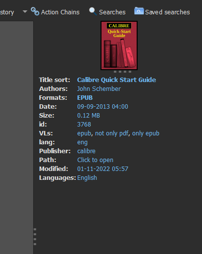

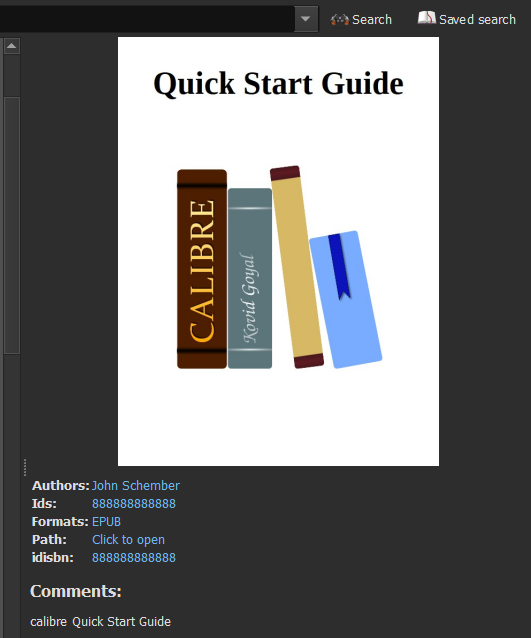

I wouldn't usually choose to have the cover show in book details pane, because it took a lot of screen real estate - unless narrowing down the entire pane size to the right.
Just ran 6.5 portable to test other things (i'm experiencing some metadata update lag, when changing custom fields, mostly...) so I took a pic for comparison:
vs

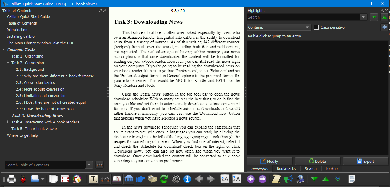

Also, I'm very happy with my new viewer setup!
Name:	MWSnap0869 2022-11-06, 06_15_02.png
