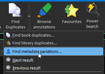

Where did you find that screen in duplicate finder?
I have installed the plug in and can't find it anywhere!!!
Thanks
Retiredjudge is offline   Reply With Quote
Thanks
Name:	2021-04-13 14_42_18-calibre.png
do you not have that menu entry?
ownedbycats is online now   Reply With Quote
Thanks
Click on the dropdown arrow beside the Find Duplicates icon. You should see Find Metadata Variations in that menu.
