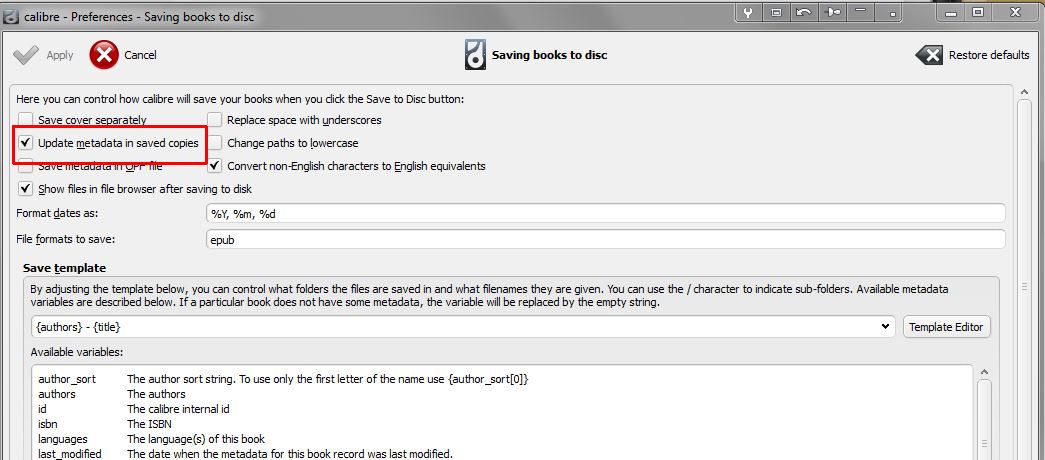

@rolandt99 - re: Save to disk - is the box ticked, see attachment
I fell into that hole too

Thanks BetterRed for your response. Checking that "update metadata in saved copies" setting was one of the first things I did. Metadata is updated in EPUB books saved to disk, metadata is NOT updated in PDF books (none, even basic title/author) saved to disk. But, even so the main "Problem" I have re-raised here is as I stated in 2) above.
