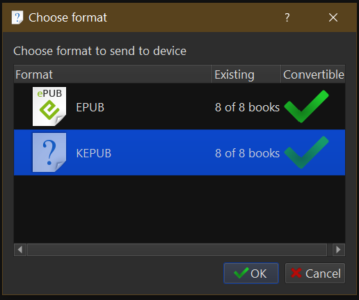

I've attached the debug log to this post and a screenshot showing what I see when I select kepub to send - I'm guessing the "?" is not a good sign

Firstly, the "?" is not an issue. That is a generic icon because calibre doesn't have one for kepubs.
