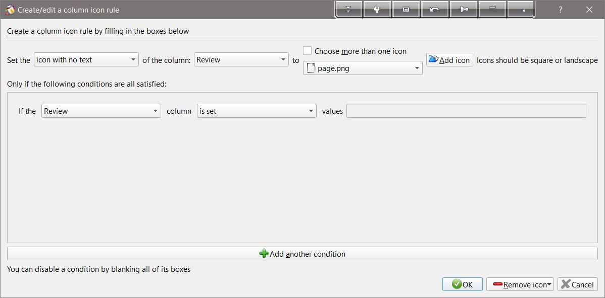

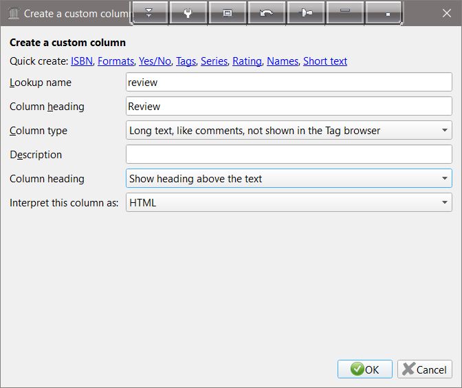

Suggestion, instead of appending your review to the Comments column, where it could get overwritten by a subsequent metadata download, add a custom column.

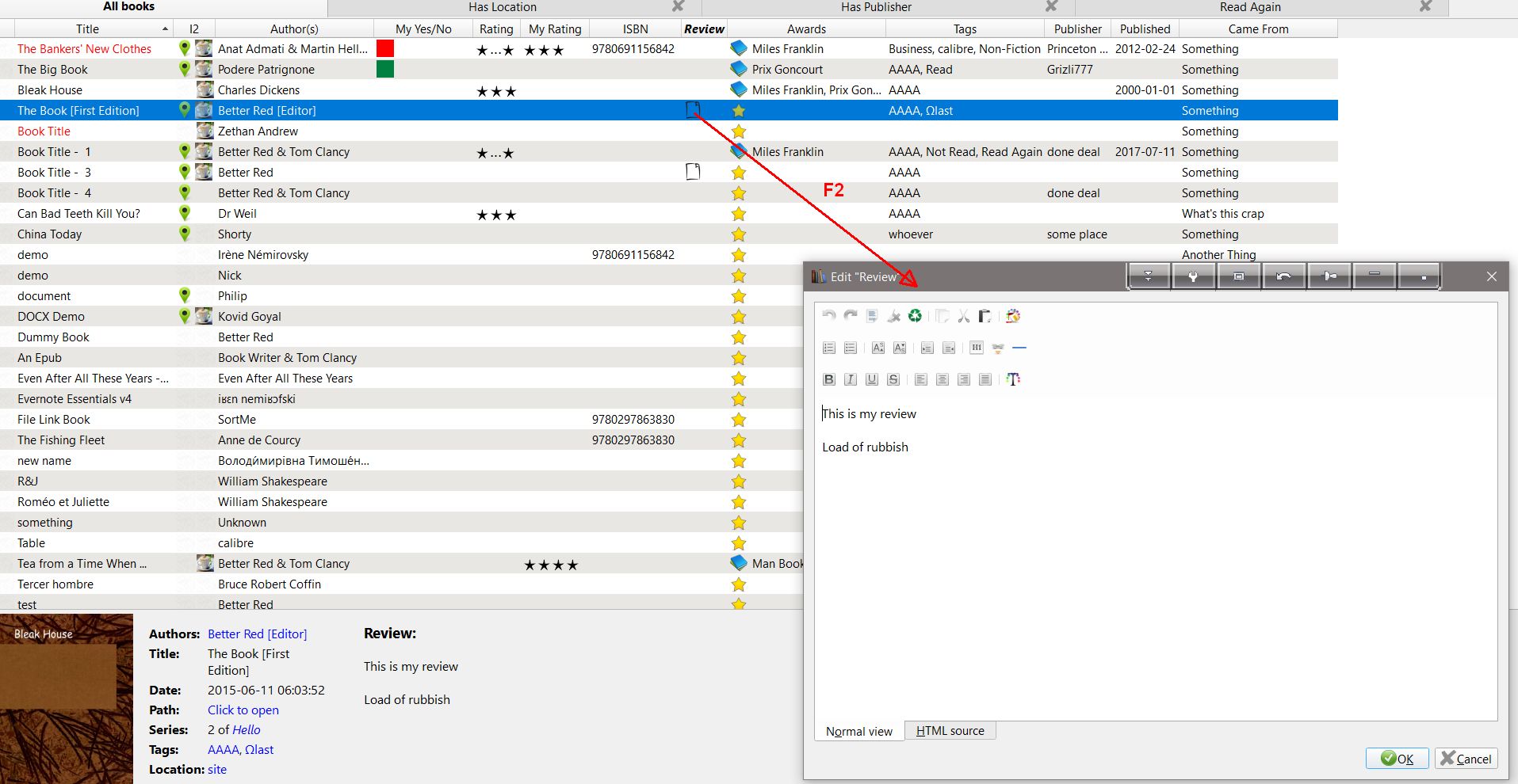

Show it as an icon in Book List
You can edit it in the Book List by tabbing to the icon and pressing F2
You'll probably want to check the Review column in the Look and Feel->Book Details tab, I would position it immediately before Comments.
