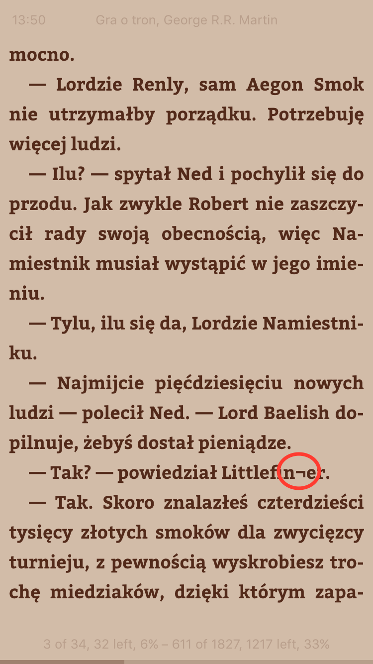

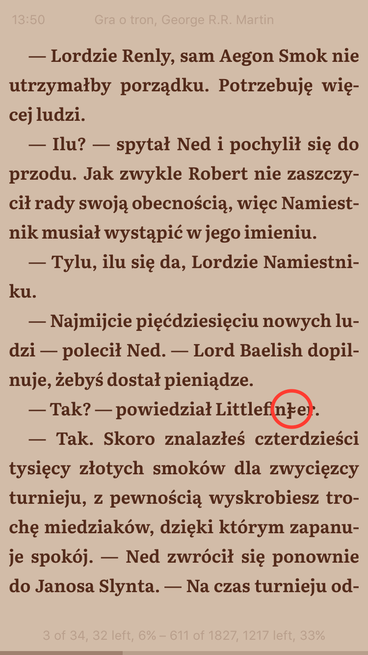

Another probably SHY related bug. Check attached screenshots. The problem is visible with Bitter font and sideloaded Literata font.
