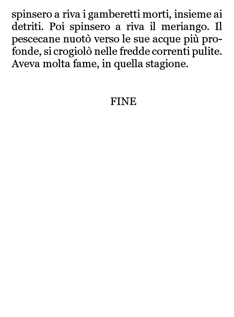

I converted it to epub with Calibre and sent it to my Glo (firmware 3.13.1), and it works OK with the Kobo epub reader, I can read to the last page, no missing text that I can see.

No I have a Glo running f/w 3.13.1 but all Kobo eReaders nasically "share" the same f/w.
An RTF will be processed by the Kobo engine, but not as an ePub. It actually IS being read as an RTF. But we have NO idea how much effort / testing has happened with that.
When I converted the RTF to ePub via calibre it was using the latest calibre build (2.20) and also I had removed the RTF from the Kobo and allowed it to process that deletion before sending the ePub version.
