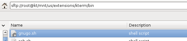

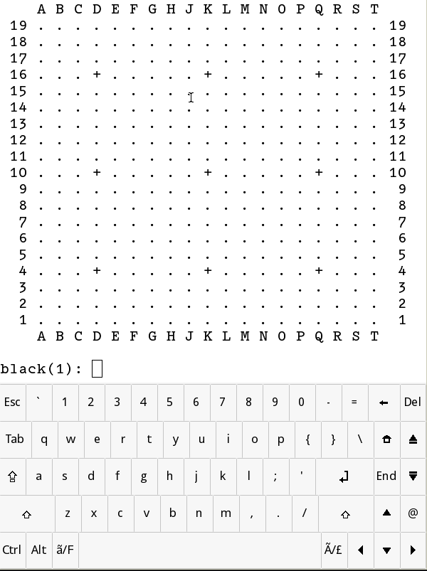

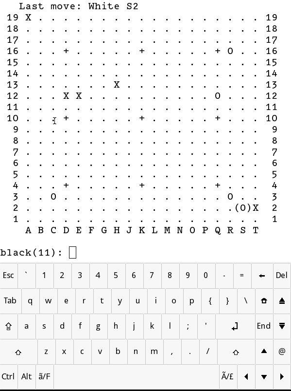

I made it (gnugo) work natively under kterm if you want it?

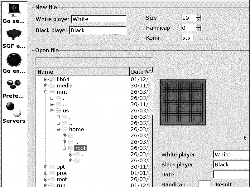

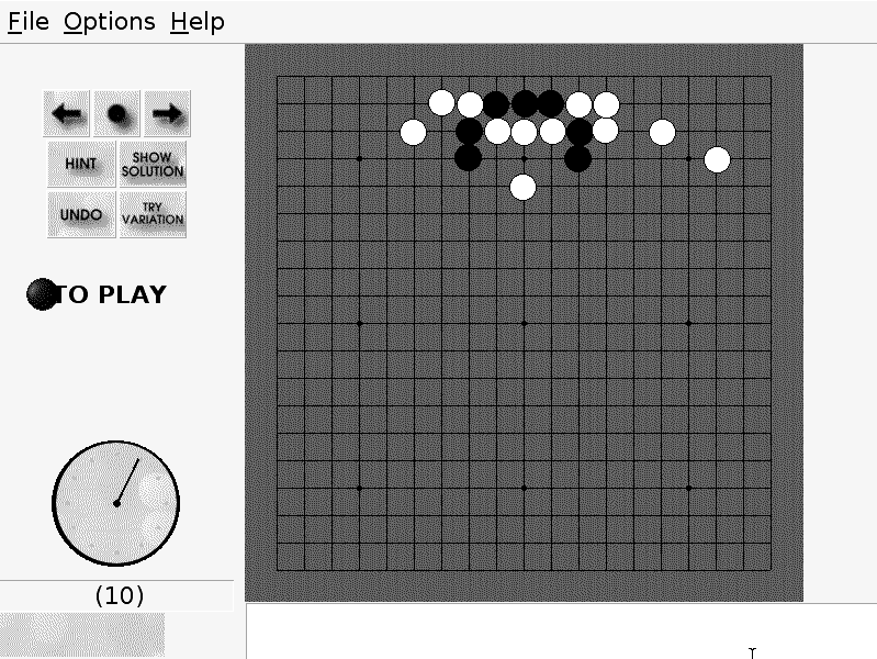

bit more luck with the debian qGo but I dont fancy my chances of getting it native without a bit of help...
(plus it is a bit "screen hungry")

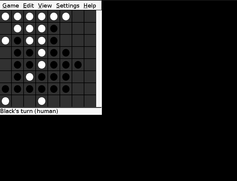

grhino looked like fun... might have a go at that one..
But no editor "wins" yet (that fit on the screen)
I think I will stop for now...

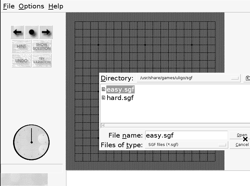

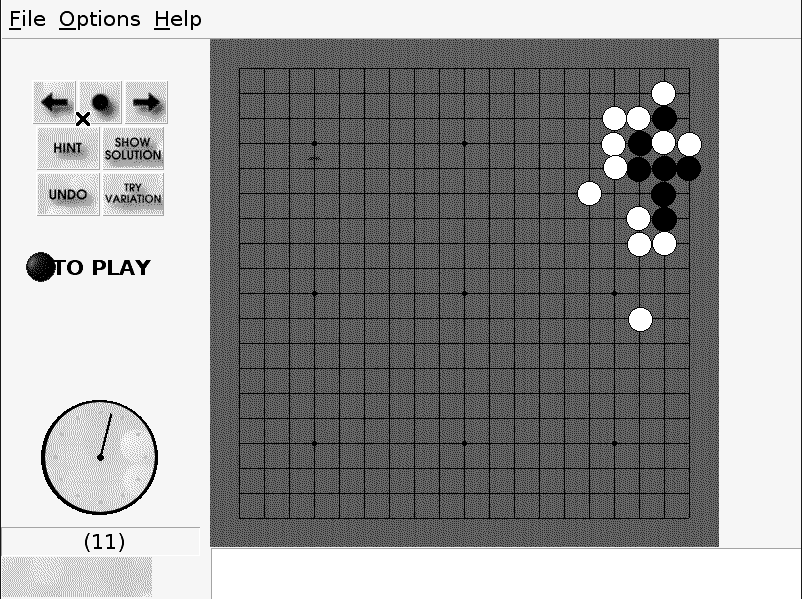

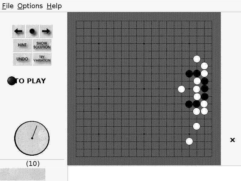

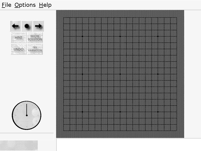

Uligo looked like it could work... but its not an editor as such?
Need more input from you. I'm no go expert...
its a pyTk soltution I think...
anyways. Fun.
EDIT: Burned WAY TOO LONG trying to get this native only to be defeated by...
version conflict for package "Tcl": have 8.5.11, need exactly 8.5.12
while executing
"package require -exact Tcl 8.5.12"
(file "/mnt/us/extensions/eboard/lib/tcl8.5/init.tcl" line 18)
invoked from within
"source /mnt/us/extensions/eboard/lib/tcl8.5/init.tcl"
("uplevel" body line 1)
invoked from within
"uplevel #0[list source $tclfile]"
This probably means that Tcl wasn't installed properly.
DOH!
Talk about close ... sigh...

As for the last few posts, Uligo is very useful in that one can practice Go problems on it using SGFs, but that makes Uligo only an SGF reader (plays out predetermined moves) rather than an editor (both reads and creates SGF). Unfortunately, it's not quite what I'm looking for, but that's not to say others (MANY others) wouldn't find it useful. I will suggest some editors in the final paragraph.
Sorry to disappoint you in this one, but grhino is actually not for Go - it's for Reversi/Othello! *hehe* You may know this already now that I mention it, but although Reversi and Go are different games it's tricky to differentiate the two cuz they use similar pieces/board (black and white round pieces on a grid).
