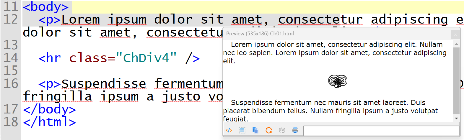

Here are a few screenshot examples:

Also, this technique is not limited to svg...it works fine with .png and .jpg...just remember it is using a mask, so none of the image detail will be visible, just a silhouette. Here are some screenshots with a .png
-webkit-mask-image: url('../Images/img_ChDiv.png')
