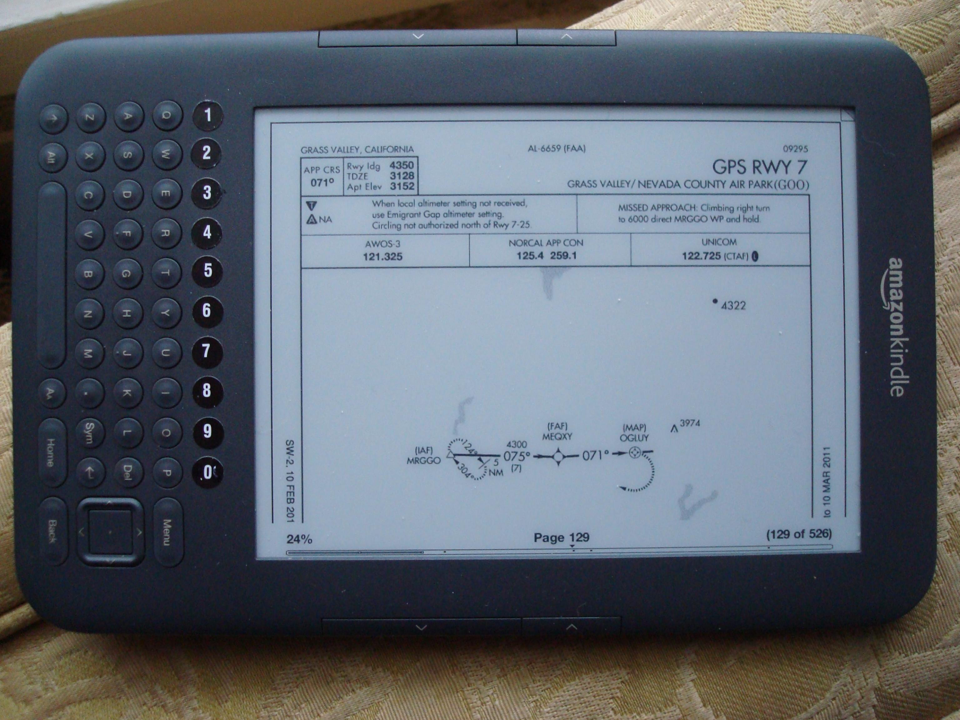

Thought I'd write up some lessons-learned from using the Kindle 3 for aviation approach plates and weather briefing.
Approach plates
The Kindle 3's pearl e-ink is simply outstanding in all lighting conditions, so this is a good fit. After much experimentation, I settled on the "compact" plates from pdfplates.com. Everyone else assumes you are using a DX for approach plates, but I hate the huge form factor and a landscape-oriented K3 is actually very serviceable. Yes, you have to click up/down to flip between the briefing strip/plan view and the profile/minimums, but the dedicated paging buttons and refresh rate make it easy and this actually tends to logically follow areas of focus, so its quite workable. Most approaches will spill over to a third page, which is annoying, but in practice this typically only contains infrequently used info, such as third set of mimimums for remote altimeter setting, etc. You can view full plates in portrait mode (if you insist, use pdfplate's "sony" format for least amount of whitespace), but they are too small for cockpit use that way (and I still have good eyes).
As most Kindle NACO compilations, pdfplates adds a page index to the beginning of the PDF as a workaround for lack of TOC support. You "GoTo beginning", note the number, then "Goto" page number. This sounds cumbersome but is actually very quick and natural way (it takes me an average 15 seconds to pull up a plate this way, vs 30+ for paper lookup). Since all this represents a lot of number entry, a row of number stickers above the QWERTY row is a helpful visual aid. (To enter a number on a Kindle, you press the "Alt" key followed by a letter, Q = 1, W = 2, etc). If anyone knows how to make the Alt sticky, let me know !!
Bookmarking: I like to gather a "brief" for an instrument flight, that is departure IDP, emergency/return proc, destination, and alternates. You can do this by pulling up the approaches of interest and bookmarking them by pressing Alt-B. The bookmark list can then be pulled from "Menu/View Notes&Marks". Unfortunately, the bookmarks do not show any part of the text (Somehow chartbundle's PDFs do, but they are unusable on the K3 for layout reasons), just page numbers. Fortunately the notes appear in the order bookmarked, and going back and forth is easy with the "Back" button.
